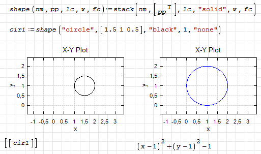

Hi. Without doubts Viacheslav use of him plugin is the better solution. But here some examples about how to setup the plot of a parametric curve using native SMath plots.
circle.sm (30.39 KiB) downloaded 1080 time(s).
Also, you can see how to determine a circle given 3 points in the space by Ber7 at https://en.smath.info/forum/yaf_postsm54516_AlgLib-3-1x.aspx#post54516

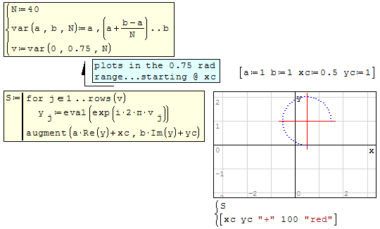

#6 Posted: 10/13/2018 7:44:46 PM
From native maths in native Smath.
... code it as a generalized companion utility.
Circle Complex.sm (14.32 KiB) downloaded 1036 time(s).
