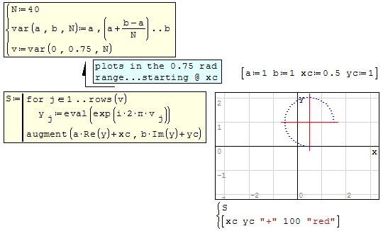

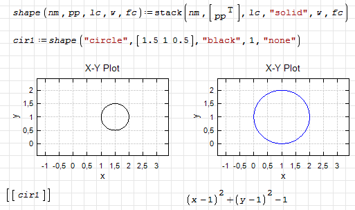

Hi. Without doubts Viacheslav use of him plugin is the better solution. But here some examples about how to setup the plot of a parametric curve using native SMath plots.
circle.sm (30,39 КиБ) скачан 1193 раз(а).
Also, you can see how to determine a circle given 3 points in the space by Ber7 at https://en.smath.info/forum/yaf_postsm54516_AlgLib-3-1x.aspx#post54516
#4 Опубликовано: 13.10.2018 11:36:28
Fridel Selitsky
Fridel Selitsky
Construction of a 3d circle on two points and a radius
(Addition of the Razonar example)
RazonarExample.sm (23,2 КиБ) скачан 1184 раз(а).
#5 Опубликовано: 13.10.2018 18:52:41
How to Plot circle using Radius and location of center ?...
From native maths in native Smath.
#6 Опубликовано: 13.10.2018 19:44:46
... code it as a generalized companion utility.
Circle Complex.sm (14,32 КиБ) скачан 1141 раз(а).
#7 Опубликовано: 13.10.2018 19:52:19
... enjoy the magic circle aperture.
Circle Magic Disk.sm (16,83 КиБ) скачан 1211 раз(а).
