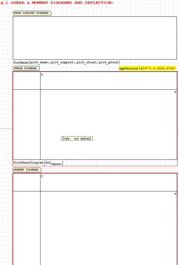

Hi everyone,
I have been using Smath for many years, but this is my first time writing to the forum
I have a problem with Structural Beam Analysis plugin. I download the Beam Analysis Input Guide from Extansions Manager and didn't change anything in the Smath file.
I couldn't figure out what is causing this situation. Do you have any idea?
Thanks in advance,

work fine for me, maybe -->
This worksheet requires that the associated Plugin (Structural Beam Analysis
Utility Functions by Redem Legaspi Jr.) be downloaded and enabled from SMath
Studio Extension Manager tool.

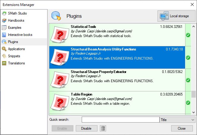

Thank you for your reply. The plugin was already enabled.

It's like there's a missing data
