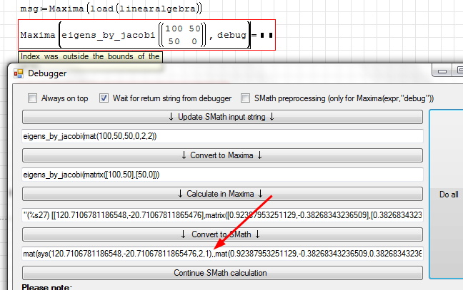

I just tried your example file. It crashes my SMath, but never mind. I copied parts of your file into another one to see what causes the problem.
I just wanted to thank you for stats package. It seems it is working
. The results are put in the system as you presented in your example.
Resizing of svg plot example is working for me as well. At the moment I do not know the details of it and how to use it for other plots using draw package, but never mind - I will figure it out sooner or later.
It seems that the problem and crash of SMath appeared just at the beginning of your example (linearalgebra regions also did not produce output). I copied the regions and "stack empty" errors appeared sometimes, sometimes crash happened. It does not look that those regions should cause problems. Actually, only by disabling the calculation of the first two math regions in your example (these first two like in the picture will suppress the SMath crash - calling functions from linearalgebra will still fail).
See the picture and the log file please.

#45 Posted: 1/2/2014 7:01:04 PM

I see your point in the drawing with many options and a problem related to them. I am not that experienced with this, and to be honest I forgot them constantly. It is impossible to memorize them. That is why we must have them available all the time.
At the moment just wanted to point out about the crashing problem of the few mentioned regions. If you have the patience just see these two videos.
Maxima crashes SMath
Debug - extra commas?
Or see the pictures, where I suppose might be a problem.

Thanks, Radovan, I can reproduce the problem and forwarded it to Kay.

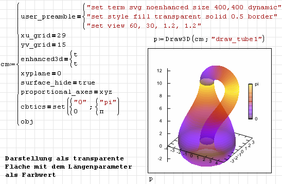

Improved version of the functions Draw2D() and Draw3D(). It is now easier to use gnuplot preamble commands (no need to include the internal terminal settings).
In the attached files there are some more example plots.

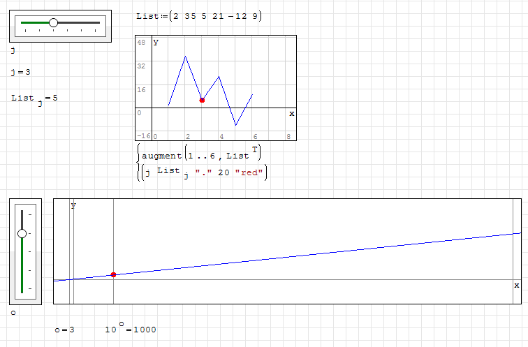

Hmm...I can not find the Slider Region in the Extensions Gallery. Where it is? It is made by Davide but I could not even guess the password this time (as I usually do)?
#52 Posted: 2/11/2014 5:07:26 AM
WroteHmm...I can not find the Slider Region in the Extensions Gallery. Where it is? It is made by Davide but I could not even guess the password this time (as I usually do)?
Don't worry, will be relased ASAP :d
