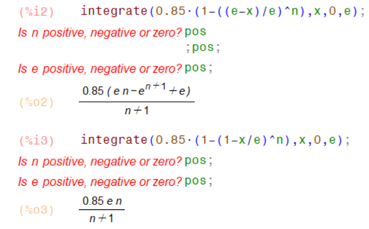

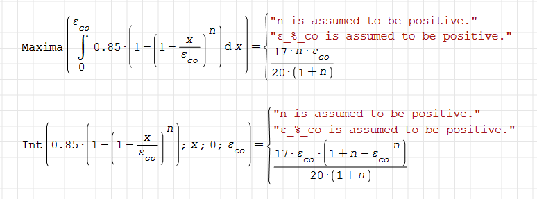

Why am I getting two different results, is this a bug?
First one is the correct result by the way.
#302 Posted: 2/24/2023 4:59:39 PM
1222 likes in 2150 posts.
This is due to the different preprocessing by SMath in the individual ways to call the maxima function. This is revealed by displaying the full maxima log.
If the expressions are evaluated in wxmaxima you get the same difference, so it is native Maxima behaviour. I'd call it a bug. This bug doesn't appear
if the assumptions are made explicitly.
symbolic integrate.sm (13 KiB) downloaded 59 time(s).
sergio 2/25/2023 6:28:00 AM

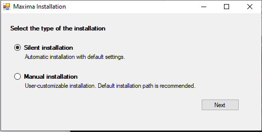

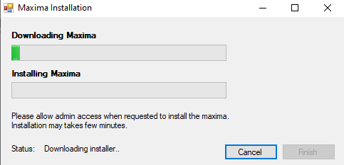

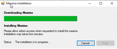

Installer Form

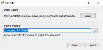

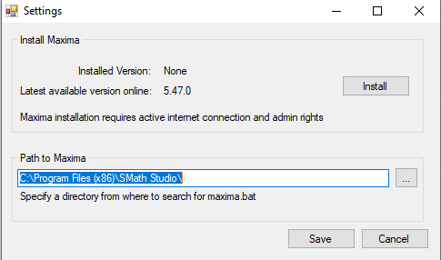

Settings Form
Maxima Installation:
To install maxima (if you don't have it on your computer), you can run any Maxima function such as MaximaTakeover() or install the maxima software via the setting form (Insert > Maxima > Settings).
The installer form will appear and immediately initiate the download of the latest Maxima installer from the internet. Once the download is completed successfully, a prompt screen will appear requesting admin privileges. Please grant admin privileges by clicking "Yes" on the prompt. The installer will then run silently. After a few minutes, the status bar at the bottom left of the installer will indicate that the installation was successful, and the "Finish" button will be enabled. Please click on the "Finish" button to complete the installation process.

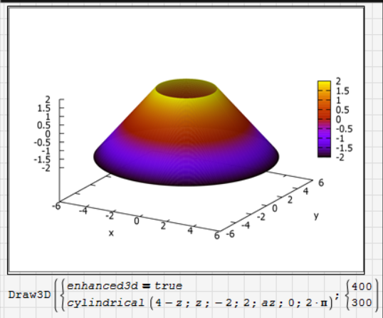

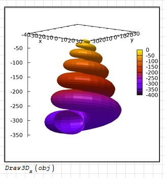

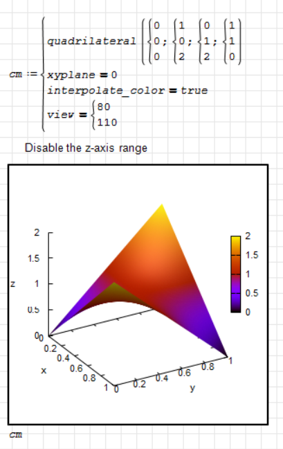

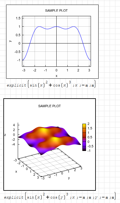

Here is an example of what can be done with Maxima 5.47, just as a teaser. Note that the plots use the Maxima Draw region (Insert> Maxima> Draw3D) with some of the settings made via the settings dialog, e.g. the color palette and the sampling density.
Like the whole Maxima plugin, the Draw regions are work in progress. In the attached sheet some issues are listed.
Draw3D_1.sm (176 KiB) downloaded 70 time(s).
3 users liked this post

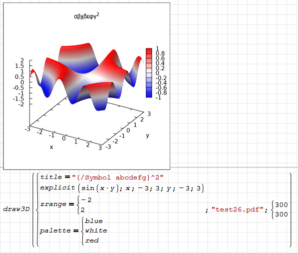

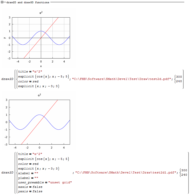

    These are prototype Draw2D and Draw3D functions, using direct Maxima commands. After some testing, the functions in the plugin get updated based on these prototypes.
    The changes are mainly adjustments to changes in the gnuplot interface.
    Also, appropriate defaults are set in order to reduce the required commands for nice plots. In particular, we want to make use of shaded plots by default.
    Note that the performance of the commands is poor. We still need to find out where the bottleneck is (Plugin, Maxima, Gnuplot?).
    Due to glitches in png format (truncated characters, bug in gnuplot or Maxima) and svg (wrong text alignment, bug of image region), we plan to make pdf the default format.
    Draw-snippet.sm (129 KiB) downloaded 72 time(s).
    Draw-snippet3d.sm (2 MiB) downloaded 81 time(s).

    The "draw" snippet has been updated. It contains the functions draw2D(2), draw2D(3) and draw3D(2), draw3D(3).
    Changes:
    - now supports pdf (recommended), png and svg format
    - Modified default grid and axes
    - default axes labels
    Due to problems with the DocumentDirectory function, the file name must be absolute. It may happen that a relative path also works but that is unreliable.
    The command "grid=false" doesn't work for removing the grid, you have to use a direct gnuplot command (user_preamble), as shown below. In the Plugin functions, we could implement a workaround (creating the preamble-entry when grid=false is found in the commands)
    Drawtest2.sm (1 MiB) downloaded 65 time(s).

    ... Due to problems with the DocumentDirectory function, the file name must be absolute. ...
    Hi Martin. I don't think the end user cares much about the file name or the intermediate format to get the graphic. In the attached file, a simple way to create a unique file name in the windows temporary directory.
    One detail: if the graph has an error, it continues to show the last correct graph, which is a bit inconvenient when it comes to making sure that things are going well.
    Drawtest2.sm (1 MiB) downloaded 72 time(s).
    sergio 7/24/2023 4:45:00 AM, Martin Kraska 7/23/2023 3:33:00 PM

    snippet "draw" is updated.
    The file name handling has been improved
    - if the name is just the extension, then a temporary file name is generated as recommended by Alvaro (and as was standard behaviour in the plugin Draw functions)
    - if a relative file name is given (test by not finding ":" in it), it is augmented by the document directory. If the file is not saved, the temp dir is used.
    - any full name is used as is.
    draw.sm (1 MiB) downloaded 74 time(s).
    sergio 7/24/2023 4:45:00 AM, Alvaro Diaz Falconi 7/24/2023 4:54:00 AM

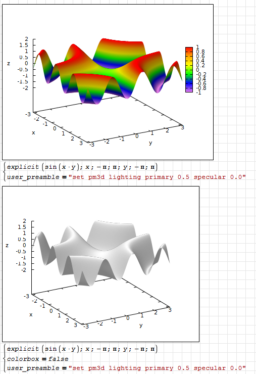

    • Introduced support for the user_preamble option.
    • Plot styling is based on the Draw2D3D-snippet.sm from previous post.

    • Standard output format is PNG, changeable via canvas double-click > Diagram Style > Picture.
    • Support for user_preamble option.
    • Plot styling follows Draw2D3D-snippet.sm.
