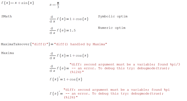

WroteHi. Can the Maxima plugin beheavior could be changed to agree with SMath (and Mathcad) diff operator, when the variable is defined?:
Thanks in advance for your answer.
This would require access to the unevaluated (non-preprocessed) verbatim expression from within the plugin. I don't know if that is currently possible. Same problem applies for definite integrals for numeric evaluation. I could take over numeric quadrature as well if I had access to the unevaluated expression.
Perhaps our other developers have a quick anwer?
Hi Martin. Clean() seems to have this kind of access.
Clear() is defined in the Special functions plugin, which is closed source and probably isn't restricted to the third party plugin API.
The Maxima plugin has already survived several API changes, sometimes Andrey made adjustments even to third party plugins immediately, sometimes major re-work is required and update delays result from that. Unfortunately, I probably will only get up and running again with Visual Studio in summer. There is quite a todo list for the maxima plugin.
Maxima has it's own mechanism for suppressing evaluation/simplification, the so called "noun" property (inactive expression). I filed support for this in the plugin as request SS-3478

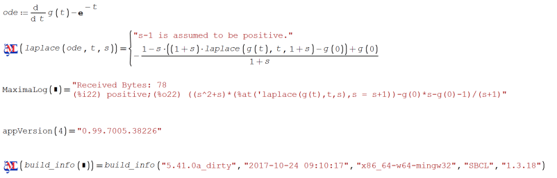

WroteHi. There are some issue here:
The problem seems to be the pre-mature execution of at() on SMath side. You see that if you switch off the Custom Functions plugin, then the answer is correctly displayed. Thus it isn't a translation issue. It would be desirable to keep the unevaluated response at least if optimization is set to "none".
I need to see if the Maxima plugin can do anything about it or even is the culprit.
Thank you for pointing this out. Filed as SS-4597.
