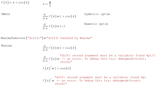

Hi. Can the Maxima plugin beheavior could be changed to agree with SMath (and Mathcad) diff operator, when the variable is defined?:

#262 Опубликовано: 13.03.2019 06:04:29
Thanks in advance for your answer.
This would require access to the unevaluated (non-preprocessed) verbatim expression from within the plugin. I don't know if that is currently possible. Same problem applies for definite integrals for numeric evaluation. I could take over numeric quadrature as well if I had access to the unevaluated expression.
Perhaps our other developers have a quick anwer?

Hi Martin. Clean() seems to have this kind of access.

Clear() is defined in the Special functions plugin, which is closed source and probably isn't restricted to the third party plugin API.
The Maxima plugin has already survived several API changes, sometimes Andrey made adjustments even to third party plugins immediately, sometimes major re-work is required and update delays result from that. Unfortunately, I probably will only get up and running again with Visual Studio in summer. There is quite a todo list for the maxima plugin.
Maxima has it's own mechanism for suppressing evaluation/simplification, the so called "noun" property (inactive expression). I filed support for this in the plugin as request SS-3478

Hi Martin. I see the request SS-3478. But I guess that this isn't related with the noun Maxima's property (x::uneval in maple, and Hold[] in Mathematica. Actually I ask some time ago something like this related with derivatives of cool prop package).
I guess that defining
bool IPluginLowLevelEvaluation.ExpressionEvaluation(Term root, Term[][] args, ref Store context, ref Term[] result)
where the difference with normal call is ref Store context, and then
termVar = SMath.Math.Computation.Preprocessing(termVar, ref context);
you can handle the case where an argument is defined, catching the variable name, and trying to determine if it is defined or not.
Actually I paste both of them from Maxima plugin source code. (But the second is commented).

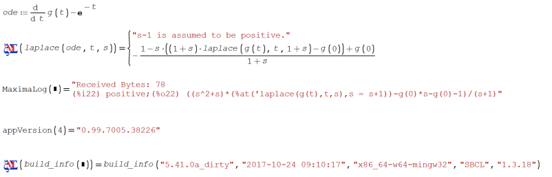

Hi. There are some issue here:
The problem seems to be the pre-mature execution of at() on SMath side. You see that if you switch off the Custom Functions plugin, then the answer is correctly displayed. Thus it isn't a translation issue. It would be desirable to keep the unevaluated response at least if optimization is set to "none".
I need to see if the Maxima plugin can do anything about it or even is the culprit.
Thank you for pointing this out. Filed as SS-4597.

Hi Martin. Thanks. Here, exp instead e^ seems to avoid this issue.
Confirmed. Thank you, filed as SS-4598
