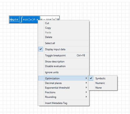

I have a portable version of Smath 0.99.7251. The Maxima is under D:\Program Files\Math Tools\SMath Studio\extensions\plugins\44011c1e-5d0d-4533-8e68-e32b5badce41\1.98.7100.23756\
I put the above path into insert->settings, but it show "Cannot find maxima.bat"
Did you install Maxima? If not, follow the link in my signature and see the instructions for installing and configuring Maxima. The plugin just provides the interface.
Thanks. I installed Maxima 5.42.2.
But still can't get result. SM file attached.
maxima.sm (2,97 КиБ) скачан 1600 раз(а).

put the optimization to symbolic or none
You have to set Optimization to Symbolic or None to display symbolic results. You can also press Ctrl+. instead of = to get symbolic results from an expression.
@Jean: maple isn't SMath native, you see that if you try it in the cloud version. Also, the legal/license status of the embedded maple executable has never been clarified. There might be people who care about this.

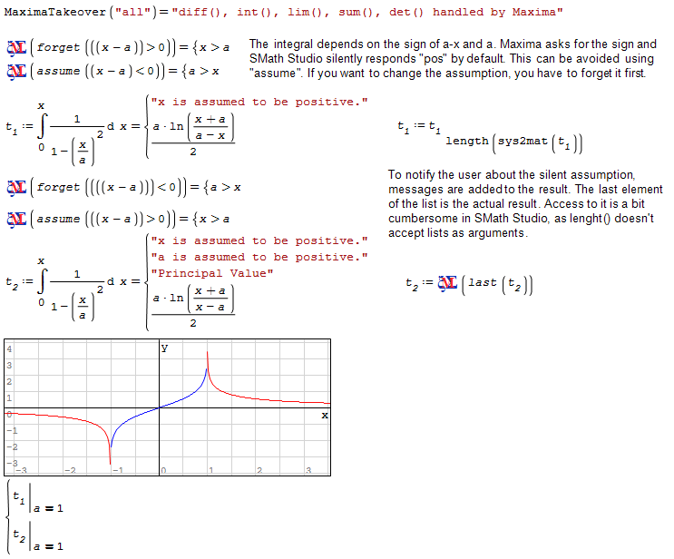

This is an example on how to control the assumptions used for symbolic integration in Maxima.
1-2-4 Widerstandskrafte.sm (12,13 КиБ) скачан 1604 раз(а).
sergio 08.10.2020 15:45:00, IVR 10.10.2020 12:24:00

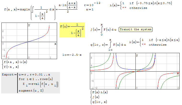

Get more from less ... typical.

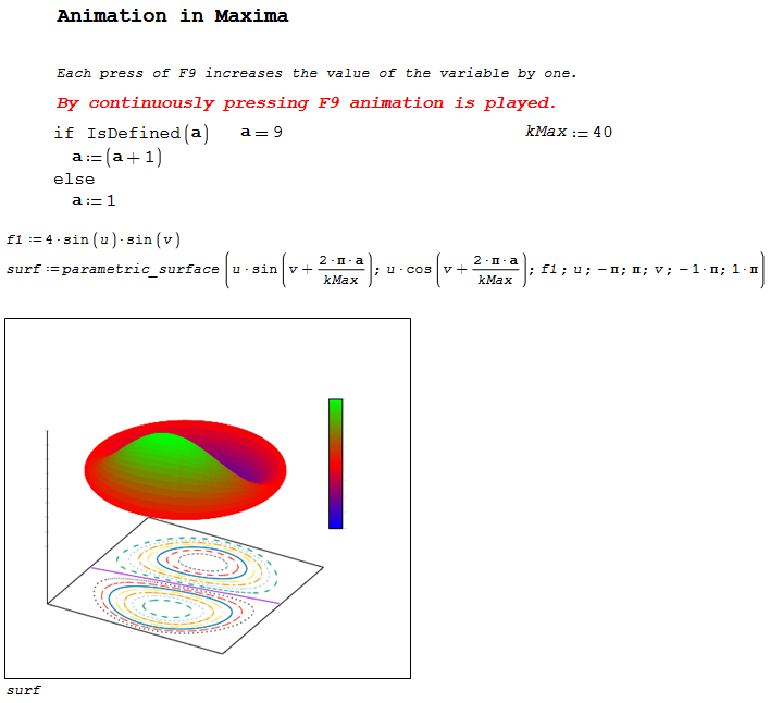

Animation in Maxima
Плагин Maxima не имеет встроенной возможности анимации.
Для создания анимации использовалась программа
https://en.smath.com/forum/yaf_postsm48012_Graph-animation.aspx#post48012
Для записи Gif файла использовалась программа GifCam.
povorot1.sm (74,29 КиБ) скачан 1581 раз(а).
SpiralMaxima.sm (45,77 КиБ) скачан 1588 раз(а).

Animation in Maxima
Very nice. Here is a version with absolute variables (names starting with ~, not easy to input with german keyboard) for execution counter. BTW, the original version reads temp storage before it is written. This throws an error similar to what would happen if I had not checked for a being undefined.
povorot1_kr.sm (75,16 КиБ) скачан 1614 раз(а).
Fridel Selitsky 23.11.2020 19:10:00

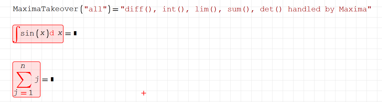

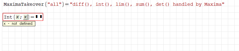

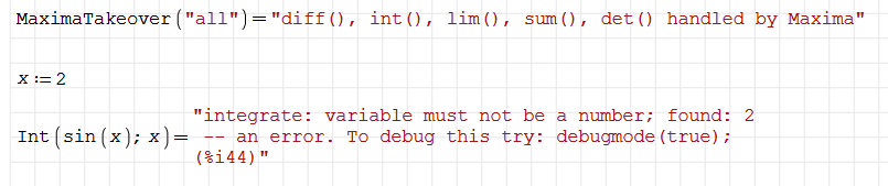

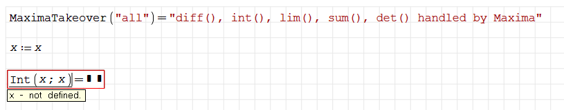

Hi Guys,
I'am using Smath for quite a while and already tried to use the Maxima plugin several times without any success.
I was able to do the setup as shown here: https://en.smath.com/forum/yaf_postst2078_Maxima-Plugin.aspx
But unfortunately in Smath the Int() function for symbolic integration never works. I'm pretty sure that I'm missing a little part. Can anyone help me please?
Example:
When I do define x I get the following error
And when I do assign something else than a number i get:

Hi Guys,
But unfortunately in Smath the Int() function for symbolic integration never works. I'am pretty sure that I'am missing a little part. Can anyone help me please?
Example:
This is because you use numeric optimization (context menu). If you expect symbolic results, use symbolic optimization ("none" also works, it shows the result from Maxima without further processing by SMath).
The error message is correct. The integration variable must be unassigned.

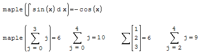

... but you have missed the best from Generous Smath Community.

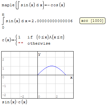

1. Always/first plot the integrand.
2. You integrate over a ranged variate.
3. maple is delivered with native Smath.
