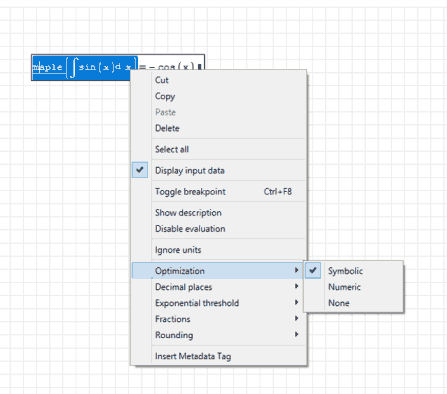

put the optimization to symbolic or none

You have to set Optimization to Symbolic or None to display symbolic results. You can also press Ctrl+. instead of = to get symbolic results from an expression.

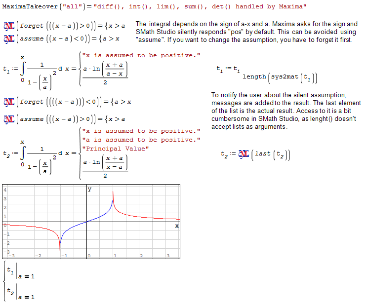

#287 Posted: 10/8/2020 7:00:15 AM
This is an example on how to control the assumptions used for symbolic integration in Maxima.
1-2-4 Widerstandskrafte.sm (12.13 KiB) downloaded 1605 time(s).

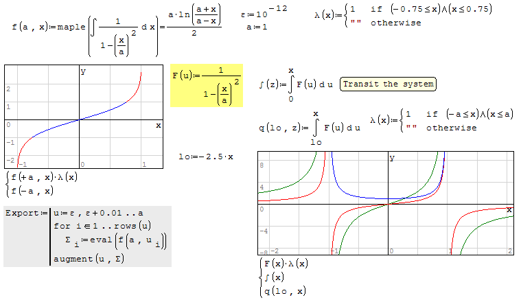

#288 Posted: 10/10/2020 8:52:49 PM
Get more from less ... typical.

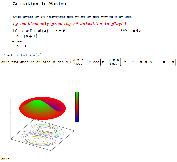

Animation in Maxima
Плагин Maxima не имеет встроенной возможности анимации.
Для создания анимации использовалась программа
https://en.smath.com/forum/yaf_postsm48012_Graph-animation.aspx#post48012
Для записи Gif файла использовалась программа GifCam.
povorot1.sm (74.29 KiB) downloaded 1582 time(s).
SpiralMaxima.sm (45.77 KiB) downloaded 1589 time(s).

Animation in Maxima
Very nice. Here is a version with absolute variables (names starting with ~, not easy to input with german keyboard) for execution counter. BTW, the original version reads temp storage before it is written. This throws an error similar to what would happen if I had not checked for a being undefined.
povorot1_kr.sm (75.16 KiB) downloaded 1617 time(s).

Thanks a lot, Martin. Wonderful! I was not aware of the IsDefined function.

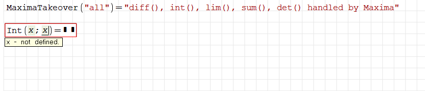

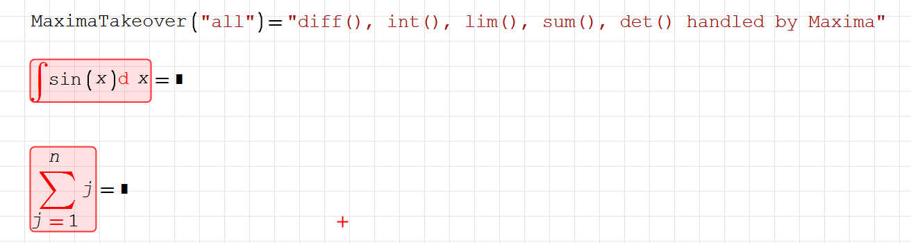

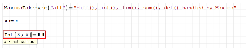

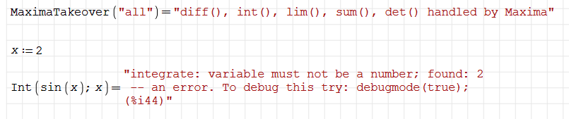

Hi Guys,
I'am using Smath for quite a while and already tried to use the Maxima plugin several times without any success.
I was able to do the setup as shown here: https://en.smath.com/forum/yaf_postst2078_Maxima-Plugin.aspx
But unfortunately in Smath the Int() function for symbolic integration never works. I'm pretty sure that I'm missing a little part. Can anyone help me please?
Example:
When I do define x I get the following error
And when I do assign something else than a number i get:
#299 Posted: 5/13/2021 5:05:17 PM
Hi Guys,
But unfortunately in Smath the Int() function for symbolic integration never works. I'am pretty sure that I'am missing a little part. Can anyone help me please?
Example:
This is because you use numeric optimization (context menu). If you expect symbolic results, use symbolic optimization ("none" also works, it shows the result from Maxima without further processing by SMath).
The error message is correct. The integration variable must be unassigned.

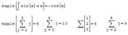

#300 Posted: 5/13/2021 8:03:57 PM
... but you have missed the best from Generous Smath Community.
1. Always/first plot the integrand.
2. You integrate over a ranged variate.
3. maple is delivered with native Smath.
