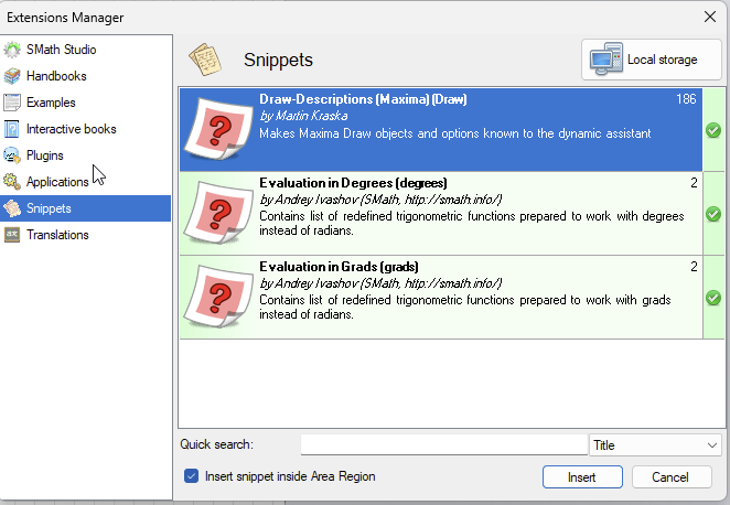

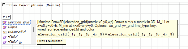

For the work with Maxima based 2D and 3D graphics, see the snippet Draw Descriptions

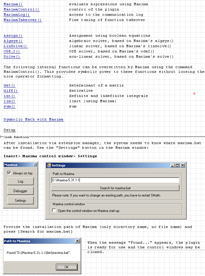

#3 Posted: 9/20/2013 11:03:39 AM
Due to registring a path to Maxima during setup, SMath is not really portable any more unless you can use the same Maxima path on different systems
[/list]
Thank you very much, Kay and Martin!!
You may want to contact the author of the portable version of Maxima at portableapps.com
http://portableapps.com/node/23391

As to the portable version. Honestly, I would rather focus on convenient and stable operation rather than on installation issues. If non-portability turns out to be prohibitive for otherwise active users, this, of course, should be handled.
But be aware that Maxima is as big as 30MB in download and 100MB unpacked.

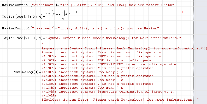

#9 Posted: 9/21/2013 3:06:21 AM
BUG/Dangerous feature:
Currently MaximaLog(), int(), diff(), lim() and sum() do not trigger start of a session!
Maxima must be started explicitly in order to take over the internal functions int(), diff(), lim() and sum().
Maxima session start can be triggered by one of
- any VALID MaximaControl() command (valid command strings are shown in the dynamic assistant)
- Maxima() with any argument accepted by SMath preprocessing
- one of the functions Solve(), LinSolve() or Algsys()
Make sure to re-calculate the document if you started the session by adding such a command into an active document.
This means that documents can behave differently depending on whether Maxima is running or not.
This is a bug/dangerous feature which we try to fix ASAP.
Meanwhile it is safe to stick to the recommendation in "Plugin Maxima.sm": Each document should at least do a cleanup at the beginning. This is to avoid interference between different open files in the same SMath instance and makes sure that Maxima is started. Use optimization> "None" or "symbolic" to see the "done".
MaximaControl("cleanup" )=done

WroteMaxima-diff() seems to trouble functions from Nonlinear Solvers. I hope this can be fixed, or Davide finds a smart way to adjust to it without rewriting everything. Last resort would be to provide the functions directly based on Maxima.
Maxima now does not overwrite the functions diff(), lim(), int() and sum(), because of the problems sum() and diff() can cause. Thus, we hope that Maxima now won't interfere with existing sheets as long as you do not ask explicitly by MaximaControl("takeover" ).

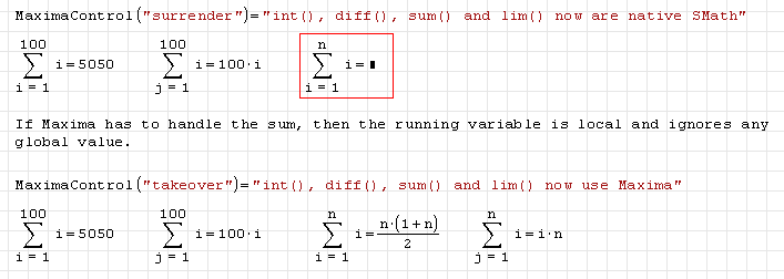

#14 Posted: 9/28/2013 8:00:51 PM
Plugin updated.
Maxima.sm (34.93 KiB) downloaded 2082 time(s).
- pi translation fixed
- sum() works but yet summation variables must be undefined
- logging and control improvements
- translation of scientific number format fixed
- translation of Maxima lists and lists of lists implemented (translated into matrices)
- SVN doc updated

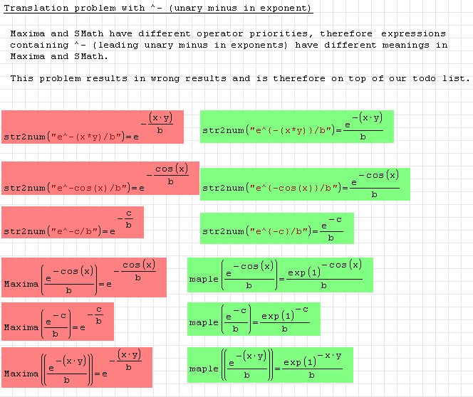

#17 Posted: 10/20/2013 1:08:24 PM
Serious translation problem with unary minus in exponents.
Currently, we see no easy way to mitigate that. The attached sheet demonstrates some alternative approaches but they all would involve more than just some regular expressions.
The reason is in the incompatible operator priority between Maxima and SMath, none of both sides can be blamed for that, except that the very low priority of unary minus in SMath is really unusual and is cause of other problems (try displaying -10°C).
Radovan Omorjan 10/20/2013 3:34:00 PM
#18 Posted: 10/27/2013 1:57:00 PM
Plugin updated.
- Translation problem with unary minus in exponents solved (thanks to Leo Butler, one of the Maxima developers)
- Dedicated function ODE.2 for solving second order ODEs (wrapper for ode2())
- Bi-directional translation of greek uppercase letters
- Unidirectional (SMath to Maxima) translation of relational and boolean operators
- Improved error message forwarding

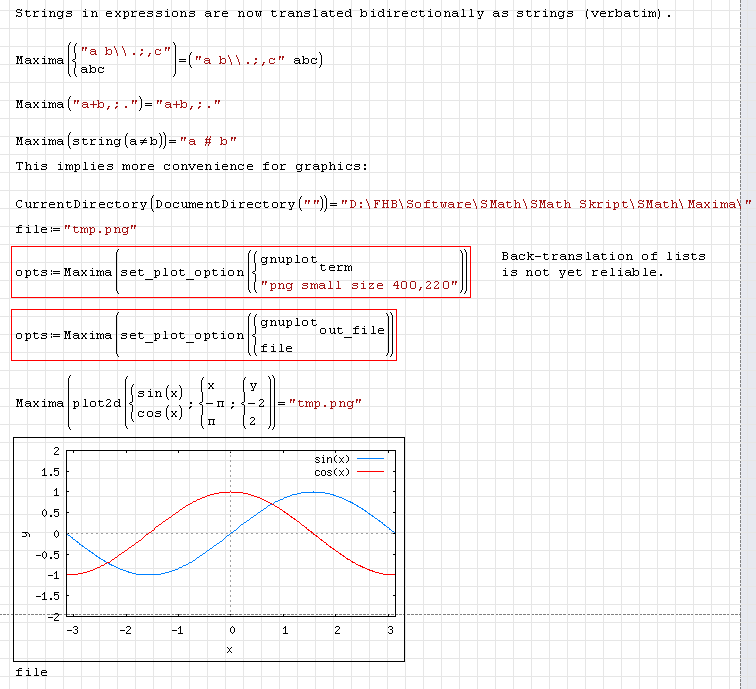

#19 Posted: 11/9/2013 1:11:01 PM
Plugin updated.
- Bidirectional transfer of string constants
-> more convenient plotting
-> Maxima string functions can be used
- Special markup for verbatim Maxima expressions ("$...$" )
- Special markup for quote character in MaximaLog() output
- Auxiliary files now reside in the plugin directory
- Bidirectional handling of different operator priorities in expressions like a^b^c or a^-b*c
