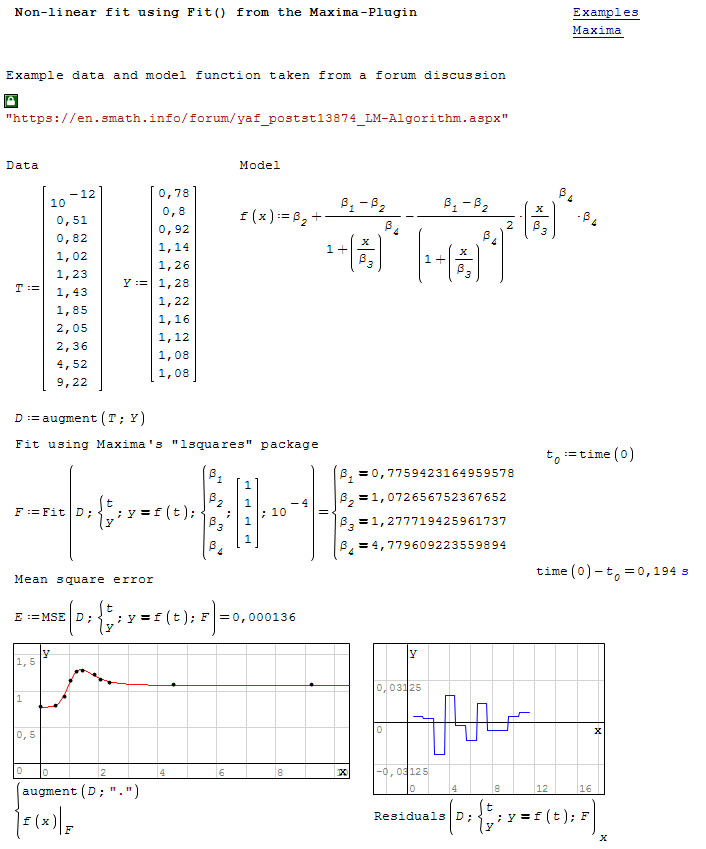

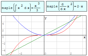

Example application for Fit(), MSE() and Residuals() and efficient plotting.
Example Fit.sm (13,62 КиБ) скачан 1589 раз(а).
Radovan Omorjan 22.09.2018 03:02:00, Вячеслав Мезенцев 22.09.2018 02:15:00, frapuano 22.09.2018 08:26:00
#251 Опубликовано: 22.09.2018 03:36:05
Thank you Martin,
I tested it briefly with a larger data set and more than one dependent variable. At a first glance it seems that it works surprisingly fast. I might have forgotten but I think there is not yet a strictly numerical procedure in SMath (available via plugin) for nonlinear fitting a quite large data set to a function with multiple dependent variables.

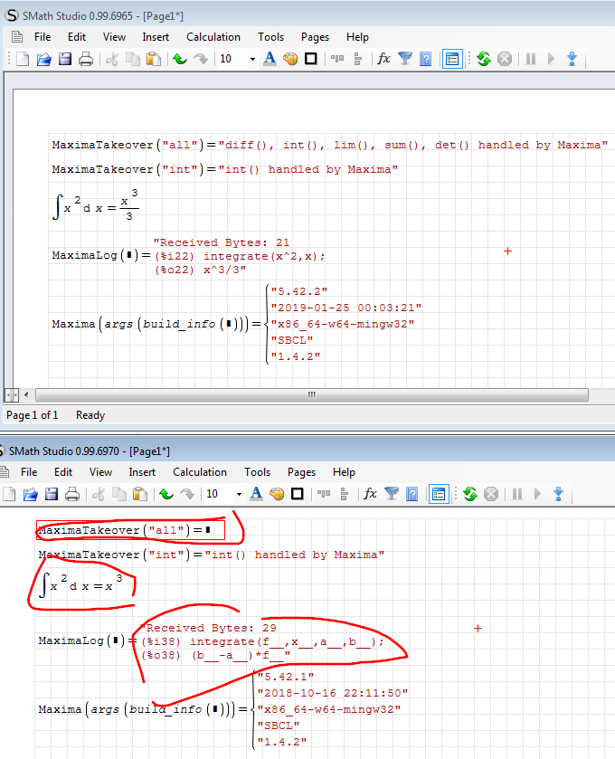

#253 Опубликовано: 25.02.2019 20:00:58
Severe problems since SMath build 6970. Last version tested ok is 6965.
maximaproblem.sm (4,28 КиБ) скачан 1589 раз(а).
#254 Опубликовано: 26.02.2019 04:03:40
Confirmed, I think...
