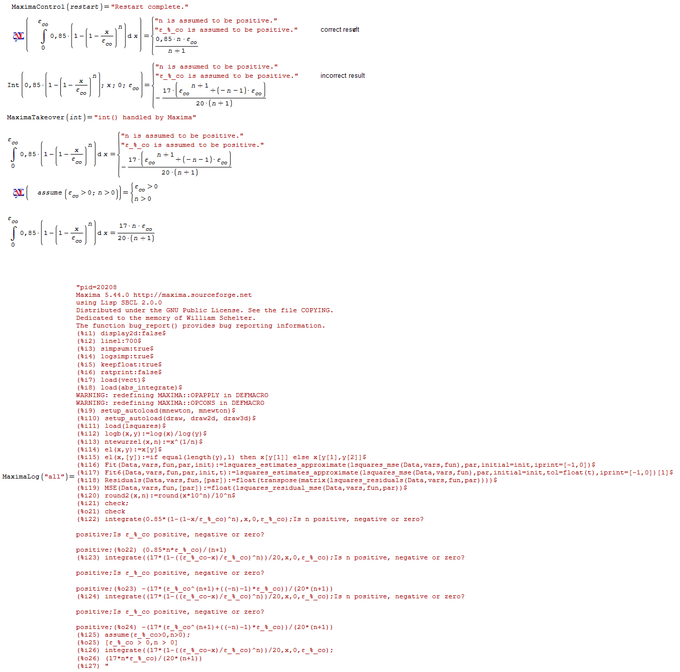

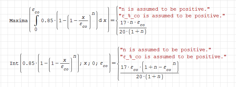

WroteWhy am I getting two different results, is this a bug?
First one is the correct result by the way.

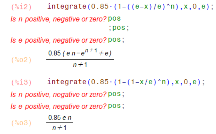

This is due to the different preprocessing by SMath in the individual ways to call the maxima function. This is revealed by displaying the full maxima log.
If the expressions are evaluated in wxmaxima you get the same difference, so it is native Maxima behaviour. I'd call it a bug. This bug doesn't appear
if the assumptions are made explicitly.
symbolic integrate.sm (13,61 КиБ) скачан 1660 раз(а).

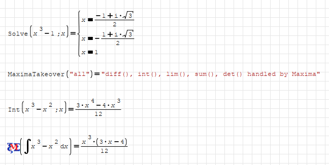

The Maxima plugin has been updated. A detailed description on the changes will follow.
Most important feature is an integrated option to install Maxima. See Insert> Settings

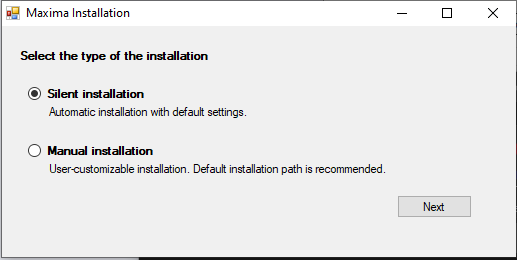

Installer Form
Settings Form
Maxima Installation:

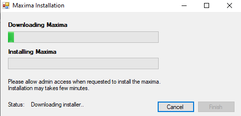

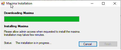

To install maxima (if you don't have it on your computer), you can run any Maxima function such as MaximaTakeover() or install the maxima software via the setting form (Insert > Maxima > Settings).
The installer form will appear and immediately initiate the download of the latest Maxima installer from the internet. Once the download is completed successfully, a prompt screen will appear requesting admin privileges. Please grant admin privileges by clicking "Yes" on the prompt. The installer will then run silently. After a few minutes, the status bar at the bottom left of the installer will indicate that the installation was successful, and the "Finish" button will be enabled. Please click on the "Finish" button to complete the installation process.
A more detailed examples of the bug fixes can be found in the following attachment: Update20.sm (77,86 КиБ) скачан 1686 раз(а).
I encourage you to try out this new update and provide feedback to help me further improve the plugin. If you encounter any bugs, please don't hesitate to let me know, and I will work on fixing them. More update will be added in the future.
Thank you!

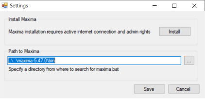

- Automatic search for Maxima in the C:\\ drive. If you have none installed, it will prompt for installation.
- Installation dialog with download bar and statuses
- Automatic download of the latest version of Maxima and silent installation with the user's permission.
- A new settings dialog with an install option.

Installer Form
Settings Form
Thank you!

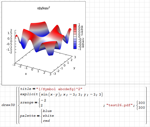

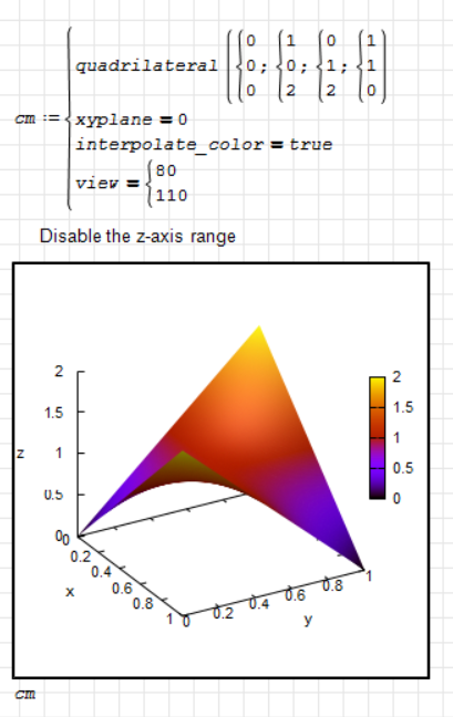

Here is an example of what can be done with Maxima 5.47, just as a teaser. Note that the plots use the Maxima Draw region (Insert> Maxima> Draw3D) with some of the settings made via the settings dialog, e.g. the color palette and the sampling density.
Like the whole Maxima plugin, the Draw regions are work in progress. In the attached sheet some issues are listed.
Draw3D_1.sm (176,59 КиБ) скачан 1579 раз(а).
![2023-07-16 22_26_39-SMath Solver 1.0.8348 - [Draw3D_1.sm].png](/ru-RU/files/Download/Svgmhn/2023-07-16-22_26_39-SMath-Solver-1.0.8348---[Draw3D_1.sm].png)

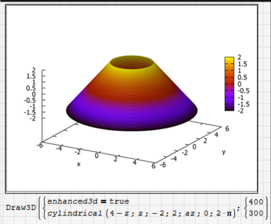

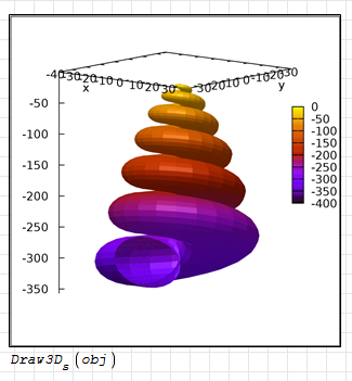

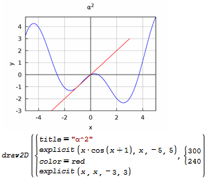

These are prototype Draw2D and Draw3D functions, using direct Maxima commands. After some testing, the functions in the plugin get updated based on these prototypes.
The changes are mainly adjustments to changes in the gnuplot interface.
Also, appropriate defaults are set in order to reduce the required commands for nice plots. In particular, we want to make use of shaded plots by default.
Note that the performance of the commands is poor. We still need to find out where the bottleneck is (Plugin, Maxima, Gnuplot?).
Due to glitches in png format (truncated characters, bug in gnuplot or Maxima) and svg (wrong text alignment, bug of image region), we plan to make pdf the default format.
![2023-07-19 02_40_00-SMath Solver - [Draw-snippet3d.sm_].png](/ru-RU/files/Download/vVZD7R/2023-07-19-02_40_00-SMath-Solver---[Draw-snippet3d.sm_].png)
Draw-snippet.sm (129,66 КиБ) скачан 1668 раз(а).
Draw-snippet3d.sm (2,49 МиБ) скачан 1783 раз(а).

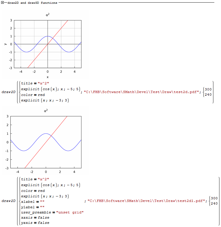

The "draw" snippet has been updated. It contains the functions draw2D(2), draw2D(3) and draw3D(2), draw3D(3).
Changes:
- now supports pdf (recommended), png and svg format
- Modified default grid and axes
- default axes labels
Due to problems with the DocumentDirectory function, the file name must be absolute. It may happen that a relative path also works but that is unreliable.
The command "grid=false" doesn't work for removing the grid, you have to use a direct gnuplot command (user_preamble), as shown below. In the Plugin functions, we could implement a workaround (creating the preamble-entry when grid=false is found in the commands)

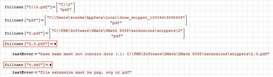

snippet "draw" is updated.
The file name handling has been improved
- if the name is just the extension, then a temporary file name is generated as recommended by Alvaro (and as was standard behaviour in the plugin Draw functions)
- if a relative file name is given (test by not finding ":" in it), it is augmented by the document directory. If the file is not saved, the temp dir is used.
- any full name is used as is.

Snippet "draw" is updated.
- The functions have been renamed to Draw2D.s and Draw3D.s in order to avoid naming conflicts during testing.
- default color palette is restored to gnuplot defaults, rainbow palette is pre-defined (use palette=rainbow)
- some bug fixing based on the attached test cases (from the SMath handbook)

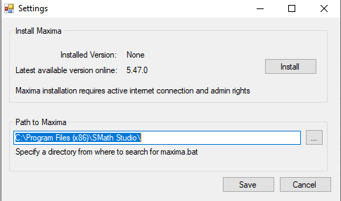

Hello Everyone,
we have updated the latest version of the plugin (as beta). Following are some of the fixes/implementation that we have done.
1. Fixed bug SS-4680: Translation problem of variable names with prime (https://smath.com/bts/Issues/IssueDetail.aspx?id=4680)
2. Fixed bug SS-216: Translation problem with Solve() and indexed variables (https://smath.com/bts/Issues/IssueDetail.aspx?id=216)
3. Further development of built-in maxima installer and settings form.
4. Updated Draw2D() and Draw3D() functions.
5. Updated Draw regions (Insert > Maxima > Draw2D / Draw3D
A more detailed description about the updates: Update21.sm (557,65 КиБ) скачан 1693 раз(а).
- Now provides information on the locally installed version and latest online version in the Insert > Maxima > Settings.
- Provides options for user to either install maxima manually (with auto download) or install it silently.
- Added progressbar for the installation process for silent installation.

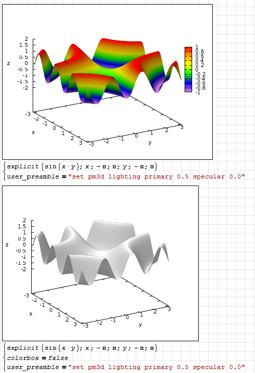

- Added PDF as an output option.
- Resolved issue with missing SVG Output generation.
- Error messages are now displayed to the user as images on errors.
- Standard output is in PDF format when no filename or extension is given as the second argument.
- Introduced support for the user_preamble option.
- Plot styling is based on the Draw2D3D-snippet.sm from previous post.
- PDF output option added.
- Issue with SVG Output resolved.
- Standard output format is PNG, changeable via canvas double-click > Diagram Style > Picture.
- Support for user_preamble option.
- Plot styling follows Draw2D3D-snippet.sm.

In this update:
1. Added Maxima Toolbox which can be found on the right side of the software.
2. Added cross product of vectors function which can be accessed by Cross() or clicking the "x" symbol in the Maxima toolbox.
3. Integrated custom glyphs for Maxima plugin which was previously handled by Custom Glyphs plugin.
4. Added "Help" and "Restart" into the "Insert" menu entry. Clicking the "Help" will redirect the user to local Maxima documentation (if maxima is installed). Clicking on the restart button will restart maxima.
5. Added mouse interaction to the 3D draw region. Plotscale can be done by holding Ctrl button while scrolling the mouse. Meanwhile Z-Scale can be done by holding Shift button while scrolling the mouse. Fixed bugs related to the draw region and scaling of windows form according to the scale of the screen.
Huge thanks to Davide Carpi for helping us with the Custom Glyphs and the Toolbox!
A more detailed description about the updates: Update22.sm (57,75 КиБ) скачан 1669 раз(а).
