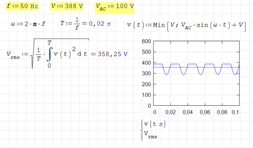

Dear Friends,
I tried to calculate the effective value of segmented voltage waveform, but failed, could you help me to fixed it? Thank you very mucn! RMS calc.sm (10.21 KiB) downloaded 858 time(s). image.png

Hi. This is a way. You can see also the file RMS in this post.
Also:
RMS-example.sm (17.81 KiB) downloaded 787 time(s).
Edited 12/9/2025 6:46:12 PM
#3 Posted: 12/10/2025 9:55:31 PM
Version without killing the units:
RMS-example.sm (8.29 KiB) downloaded 788 time(s).
In the original version, just making the periodicity function unit-proof, is sufficient:

OH! I see! Thank you Alvaro!
Wen.

It helps a lot, thank you very much!
wen.
