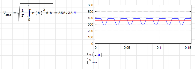

Dear Friends,
I tried to calculate the effective value of segmented voltage waveform, but failed, could you help me to fixed it? Thank you very mucn! RMS calc.sm (10,21 КиБ) скачан 858 раз(а). image.png

Hi. This is a way. You can see also the file RMS in this post.

Version without killing the units:
RMS-example.sm (8,29 КиБ) скачан 788 раз(а).
In the original version, just making the periodicity function unit-proof, is sufficient:

OH! I see! Thank you Alvaro!

It helps a lot, thank you very much!
