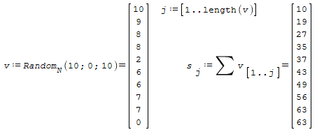

Secondly in the last page there is a 2D-graph. One can easily read the intersection of two lines however is there any solution to find the intercept of two lines when they aren't functions but are rather data points?

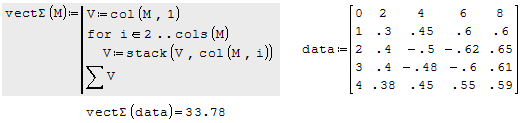

Jean Giraud, why do you add Line in the following code, I mean why not just type them separately or am I missing something?

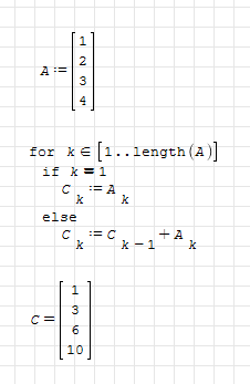

Jean,
Why did you use Sum(1) with a J loop?
Ioncube,
Just use Sum(4)

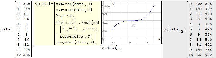

Yes my friend, you are missing best using Smath feature,
1. the line | collects/instructs the project
2. the { collects for plotting
Visit attached Project PR EOS.sm
Here is your plot and cumulative.
Project PR EOS.sm (129.66 KiB) downloaded 1105 time(s).

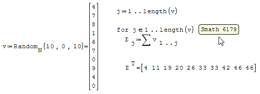

mkraska, thanks for helping, but your file is created with a newer version of SMATh & throws error in my current version 0.98.6528
#14 Posted: 4/24/2018 12:11:37 AM
You are right: Martin latest version throws error in my 6179.
I love Martin code ... Bingo !
The code I provided should work, as it did previous Smath 5346.
#15 Posted: 4/24/2018 12:28:22 AM
Try that in your version.

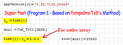

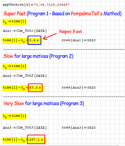

I tested 3 programs to find the cumulative totals of a large array of 20820 elements.
The method of Sergio was incredibly fast, while other two methods were much slower.
Thanks Sergio.
Forgot to attach DATA file
Rainfal_Data.xlsx (486.31 KiB) downloaded 749 time(s).
Cumulative Sum of a Large Matrix.sm (30.38 KiB) downloaded 1086 time(s).

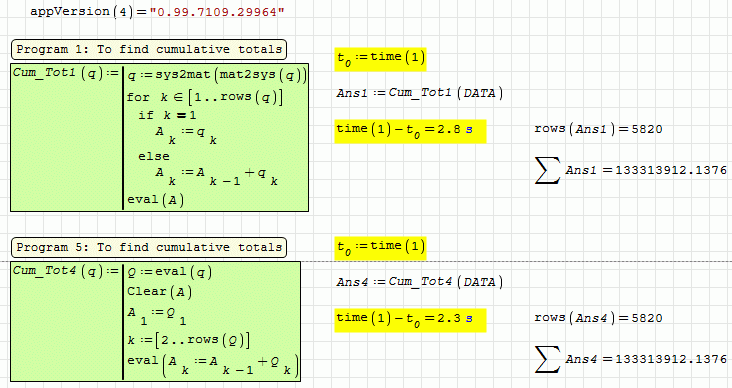

#17 Posted: 8/9/2019 5:38:20 AM
Hi Nugegodage. Try this other one.
Cumulative Sum of a Large Matrix.sm (25.32 KiB) downloaded 1361 time(s).
(Notice that mi computer is very slow)

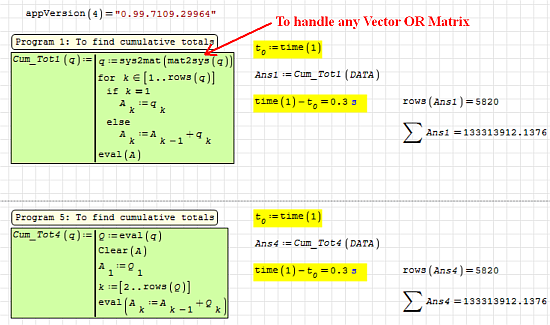

#18 Posted: 8/9/2019 11:33:32 AM
NDTM Amarasekera
NDTM Amarasekera
130 likes in 352 posts.
Hello Alvaro
I get following result in my laptop.
Yours is a very good alternative.
Thanks.
