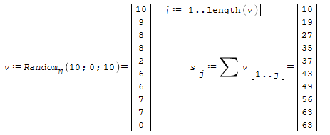

#6 Опубликовано: 23.04.2018 16:48:03
cumulatively adds vector elements
... as you wish
#7 Опубликовано: 23.04.2018 16:56:06
Maths Vectorize.sm (9,06 КиБ) скачан 1114 раз(а).

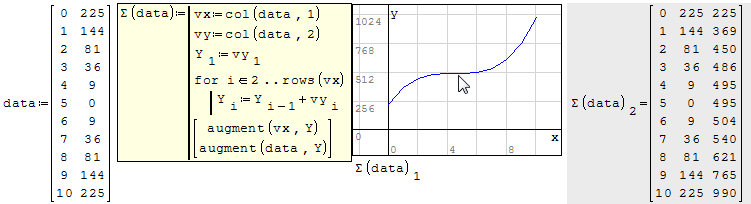

#11 Опубликовано: 23.04.2018 20:27:53
cumsum.sm (3,95 КиБ) скачан 1058 раз(а).
#12 Опубликовано: 23.04.2018 21:47:19
Jean Giraud, why do you add Line in the following code, I mean why not just type them separately or am I missing something?
Yes my friend, you are missing best using Smath feature,
1. the line | collects/instructs the project
2. the { collects for plotting
Visit attached Project PR EOS.sm
Here is your plot and cumulative.
Project PR EOS.sm (129,66 КиБ) скачан 1105 раз(а).

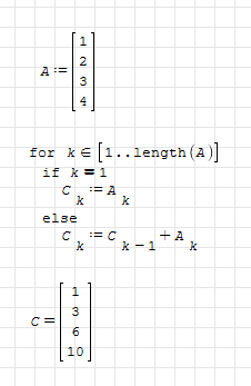

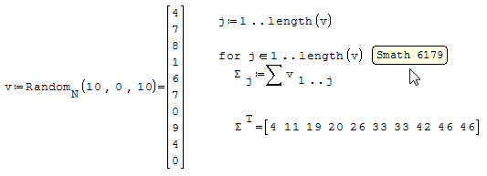

#15 Опубликовано: 24.04.2018 00:28:22
You are right: Martin latest version throws error in my 6179.
Try that in your version.

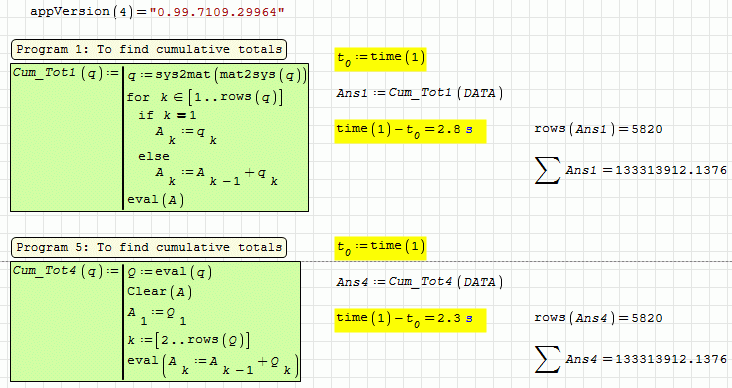

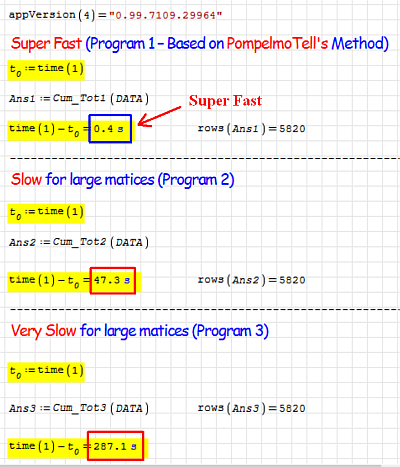

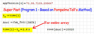

I tested 3 programs to find the cumulative totals of a large array of 20820 elements.
The method of Sergio was incredibly fast, while other two methods were much slower.
Thanks Sergio.
Forgot to attach DATA file
Rainfal_Data.xlsx (486,31 КиБ) скачан 749 раз(а).
Cumulative Sum of a Large Matrix.sm (30,38 КиБ) скачан 1086 раз(а).

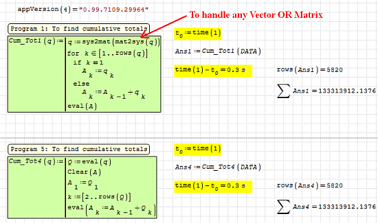

Hi Nugegodage. Try this other one.
Cumulative Sum of a Large Matrix.sm (25,32 КиБ) скачан 1361 раз(а).
(Notice that mi computer is very slow)
sergio 09.08.2019 06:43:00, frapuano 09.08.2019 10:47:00, NDTM Amarasekera 09.08.2019 11:43:00
#18 Опубликовано: 09.08.2019 11:33:32
NDTM Amarasekera
NDTM Amarasekera
Hello Alvaro
I get following result in my laptop.
Yours is a very good alternative.
Thanks.

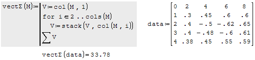

#19 Опубликовано: 09.08.2019 13:31:37
... the word is array
1. Unwrap the array in vector
2. ΣV ... vector sum over the unwrapped array
SS 6179 does not open your document.
#20 Опубликовано: 09.08.2019 19:12:35
...more and otherwise.
vectSum.sm (15,92 КиБ) скачан 1222 раз(а).
