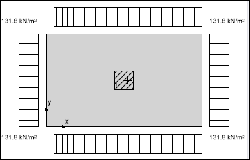

I'm using SMath to create simple structural engineering calculations.
I'd like to add sketches/visualizations of the calculated structure.
What would be the best tools to achieve this?
Here's an example of what I'm trying to do.
Best regards, Olli

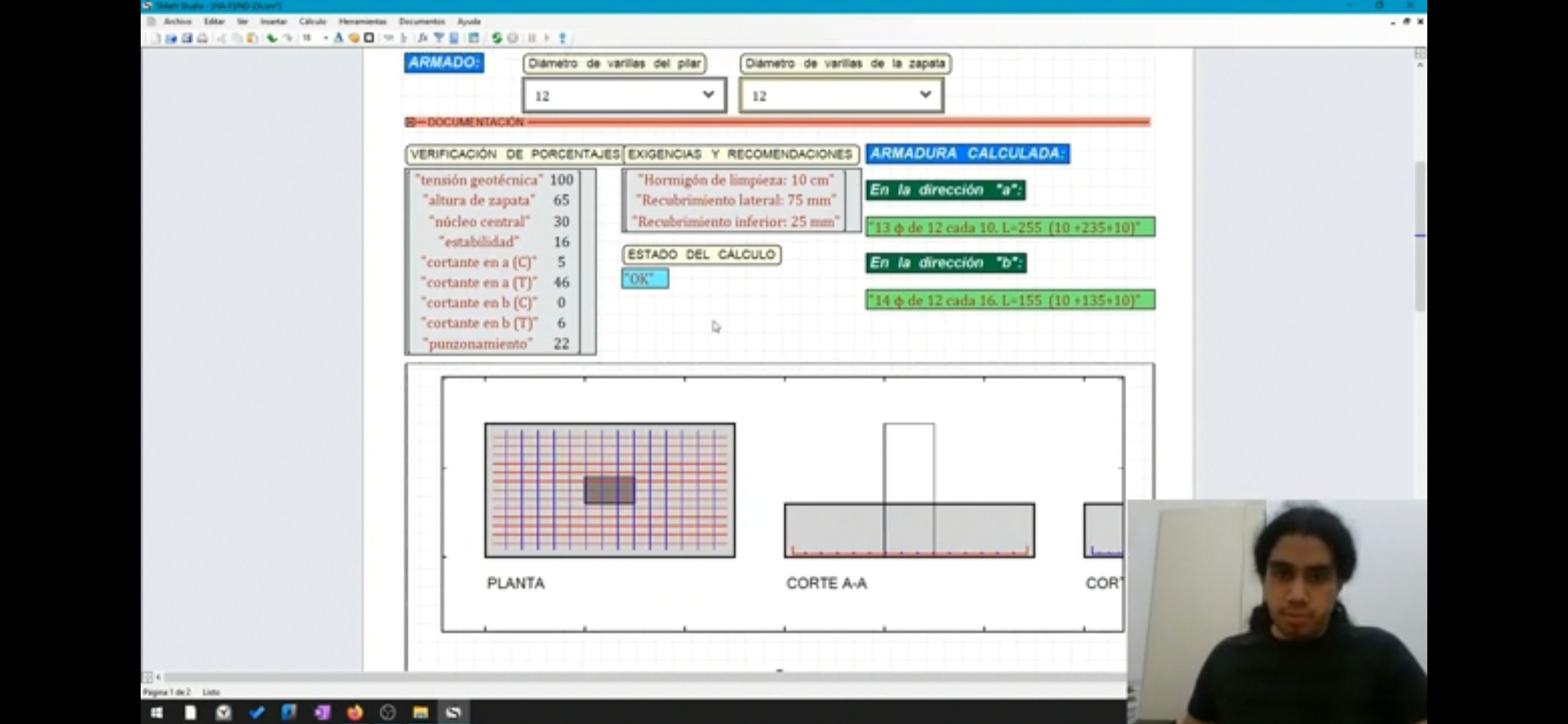

#2 Posted: 3/1/2023 11:20:12 AM
What would be the best tools to achieve this ?
Otherwise suggestion.
1. As many grid as you want
2. Range the ± span
3. Display the XY points from calculation.
If that will make you happy ... please let's know.
