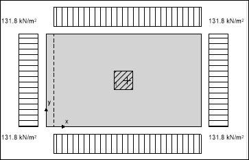

I'm using SMath to create simple structural engineering calculations.
I'd like to add sketches/visualizations of the calculated structure.
What would be the best tools to achieve this?
Here's an example of what I'm trying to do.
Best regards, Olli

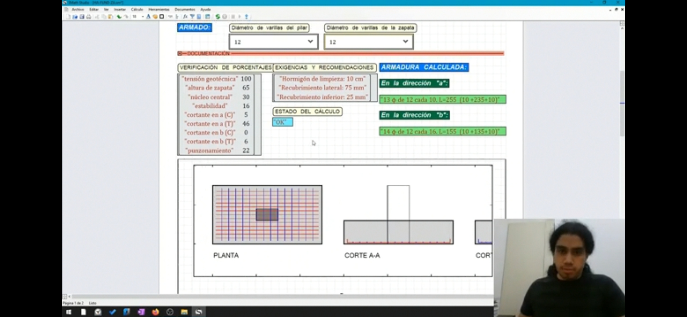

#5 Опубликовано: 01.03.2023 13:54:10
1 532 сообщений из 1 846 понравились пользователям.
SMath Studio Course
https://www.youtube.com/playlist?list=PLmlHs7mJNSf_towybanvlf-yd-hTx3shc
