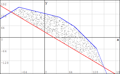

#4 Posted: 9/28/2019 1:21:02 PM
2D Plot Discontinuous [min(,)].sm (14.78 KiB) downloaded 967 time(s).
#5 Posted: 9/28/2019 2:31:28 PM
... Dichotomy added for solving in the complex region.
2D Plot Discontinuous [min(,)].sm (27.31 KiB) downloaded 942 time(s).
#6 Posted: 9/28/2019 6:35:33 PM
filling the loft added.
2D Plot Discontinuous [min(,)].sm (44.7 KiB) downloaded 969 time(s).

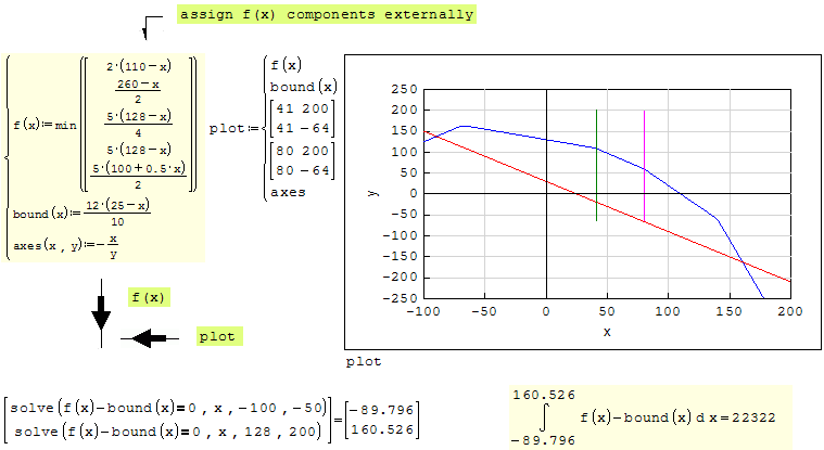

#8 Posted: 10/1/2019 8:35:03 AM
but how do you set your graph axis
1. Dispose the plot from plotting using Smath @ QuickPlot
zoom, shift left/right, up/down ...
2. Plot on the X_Y, set the X ± limits, Y ± limits.
3. plot ... 4. specify the traces from "list"
As simple as explained, no sweat ! ... Last plot.
2D Plot Discontinuous [min(,)].sm (44.49 KiB) downloaded 969 time(s).

#12 Posted: 10/2/2019 11:19:45 PM
dio pants
dio pants
16 likes in 180 posts.
I think that you are missing out on a great number of improvements to SMath if you are still using version 6xxx...
Here are 2 screen grabs-
1. The right click-format method. It works, but it is VARY tedious, and if you happen to click in the graph and move or scroll, the whole thing gets thrown off.
2. Using the XYPlotProps that alyles suggested allows the user to define the format to things like the axis limits and tics and the grid and the like.
The added benefit to this method is that if you happen to mess up the formatting of the graph, you can simply recalculate and it will reset the graph to the limits defined.
UserPostedImage
UserPostedImage
frapuano 10/3/2019 2:57:00 AM
