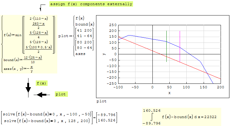

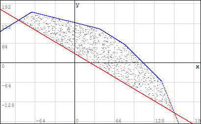

2D Plot Discontinuous [min(,)].sm (14,78 КиБ) скачан 864 раз(а).
#5 Опубликовано: 28.09.2019 14:31:28
... Dichotomy added for solving in the complex region.
2D Plot Discontinuous [min(,)].sm (27,31 КиБ) скачан 848 раз(а).
#6 Опубликовано: 28.09.2019 18:35:33
filling the loft added.
2D Plot Discontinuous [min(,)].sm (44,7 КиБ) скачан 864 раз(а).

#8 Опубликовано: 01.10.2019 08:35:03
but how do you set your graph axis
1. Dispose the plot from plotting using Smath @ QuickPlot
zoom, shift left/right, up/down ...
2. Plot on the X_Y, set the X ± limits, Y ± limits.
3. plot ... 4. specify the traces from "list"
As simple as explained, no sweat ! ... Last plot.
2D Plot Discontinuous [min(,)].sm (44,49 КиБ) скачан 877 раз(а).
