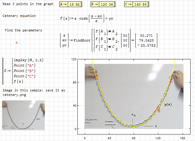

#5 Posted: 9/26/2024 4:36:41 AM
1,080 likes in 1,752 posts.
... the question was not about y(X), but al_nl****
Hi. Using the new functionality of XYPlot:
Image with size 161x112:
Smath file: img-catenary-al_nleqsolve.sm (19.15 KiB) downloaded 1027 time(s).
