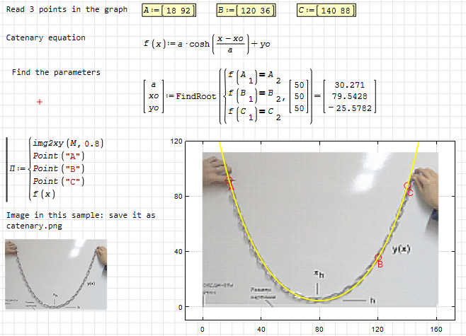

How to use here the al_nl plugin?

IMHO - Catenary and parabola are different things.
Thanks. I know it, but the question was not about y(X), but al_nl****

... the question was not about y(X), but al_nl****
Hi. Using the new functionality of XYPlot:
Image with size 161x112:
Smath file: img-catenary-al_nleqsolve.sm (19,15 КиБ) скачан 1436 раз(а).
