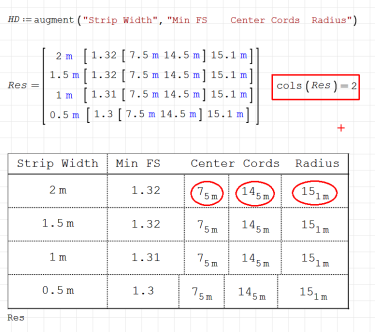

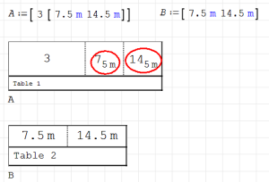

Hello !
I have this display problem when trying to pass
a matrix to a Table.
Table_Region_Problem.sm (11.47 KiB) downloaded 1495 time(s).

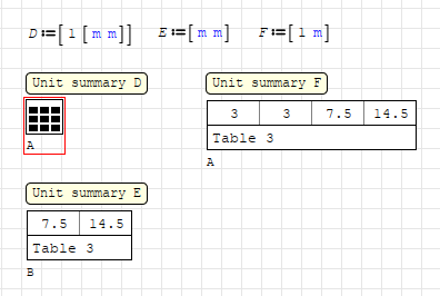

Unit summary doesn't work as it should either.
Maybe these are bugs. Regards

Hello !
My post #1 is a simple example to show the Table Region problem.
The actual problem is related to a Slope Stability Analysis example,
where the result consist of the following.
1. Strip width
2. Relevant Min Factor of Safety (Min_FS)
3. Center cordinates (x,y) of slip circle relevant to Min_FS
4. Corresponding Radius of slip circle.

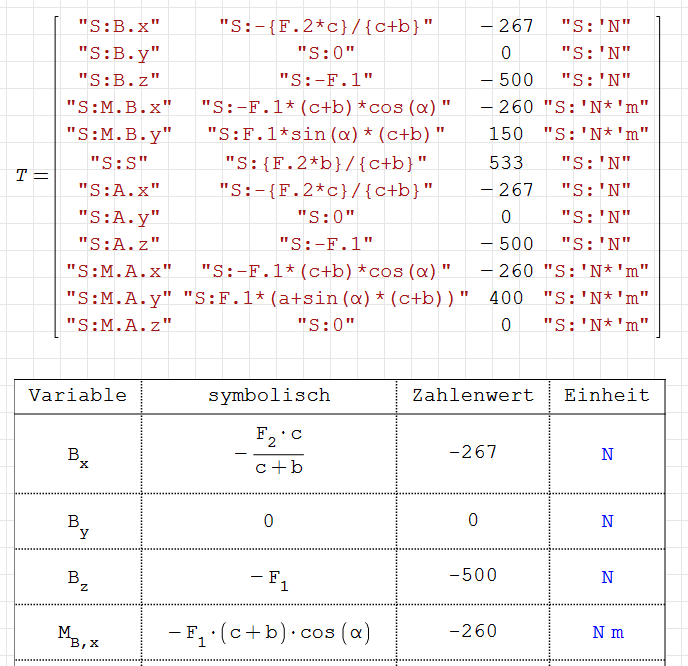

In the attached sheet I tried to automatically compile a results summary. Note that there is a single entry point for unit specification in the algorithm (no chance for mismatch between displayed unit and unit used to calculate the numerical values.
1-3.sm (137.75 KiB) downloaded 1485 time(s).
