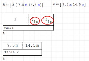

I have this display problem when trying to pass
a matrix to a Table.
Table_Region_Problem.sm (11,47 КиБ) скачан 1377 раз(а).

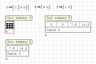

Unit summary doesn't work as it should either.
Maybe these are bugs. Regards

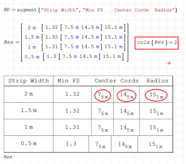

My post #1 is a simple example to show the Table Region problem.
The actual problem is related to a Slope Stability Analysis example,
where the result consist of the following.
1. Strip width
2. Relevant Min Factor of Safety (Min_FS)
3. Center cordinates (x,y) of slip circle relevant to Min_FS
4. Corresponding Radius of slip circle.

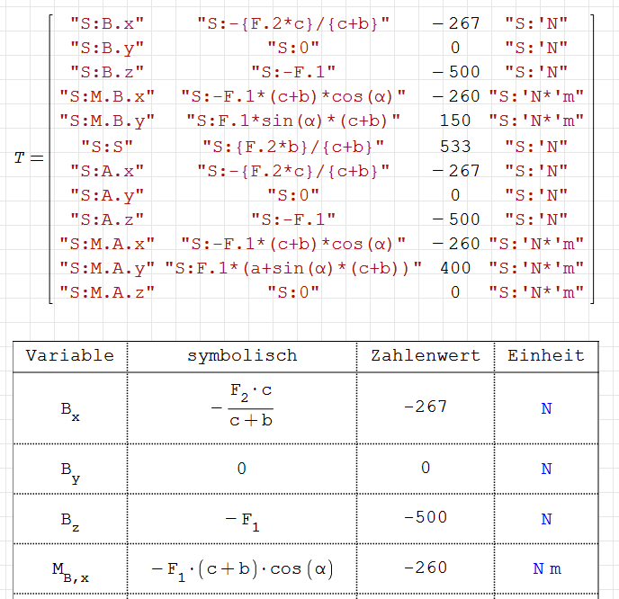

In the attached sheet I tried to automatically compile a results summary. Note that there is a single entry point for unit specification in the algorithm (no chance for mismatch between displayed unit and unit used to calculate the numerical values.
1-3.sm (137,75 КиБ) скачан 1374 раз(а).
At post #3 construct the matrix as independent cols, thus compatible Table.
Next, nest the two pertinent cols to explicit your Engineering c/w header.
