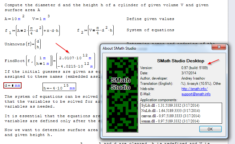

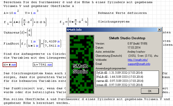

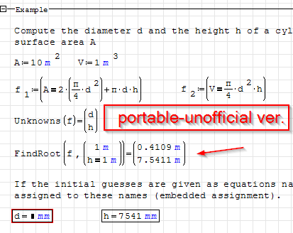

#4 Posted: 5/3/2014 7:45:18 AM
By the way Martin,
I might missed it, but I think there is still no answer about the differences between the official (wrong) and unofficial-portable (correct) and FindRoot() example
#5 Posted: 5/3/2014 7:56:06 AM
Can't reproduce this. Based on 0.97.5189 there is no difference between portable and non-portable version.
#6 Posted: 5/3/2014 9:31:29 AM
This is quite strange . Could someone else else try to reproduce this please.
This is only happening to me with the official (regular) install

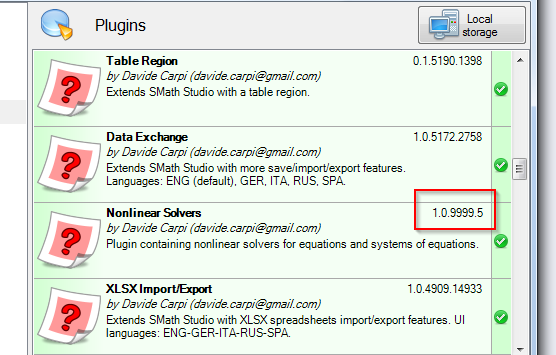

#7 Posted: 5/3/2014 10:18:48 AM
NS version is 1.0.9999.5 for both of you (Martin and Radovan)?
#8 Posted: 5/3/2014 10:24:19 AM
I confirm version 1.0.9999.5 according to plugin dir name. I also tried to change arg/dec sep settings to komma/period and get the same (correct) result.
Davide Carpi 5/3/2014 10:25:00 AM
#9 Posted: 5/3/2014 11:13:12 AM
Hello Davide,
I also confirm the plugin version - see the picture please.
BTW, this is the same on my both computers home-Win7 32bit, office-Win7 64bit
Davide Carpi 5/3/2014 11:14:00 AM
#10 Posted: 5/3/2014 11:18:37 AM
Thanks... I'll check it ASAP, just want to share the latest couple of controls and then I'll go back on this plugin
