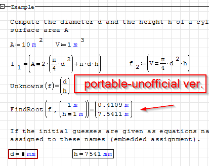

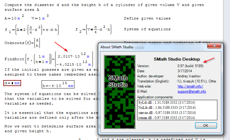

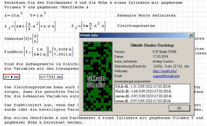

I might missed it, but I think there is still no answer about the differences between the official (wrong) and unofficial-portable (correct) and FindRoot() example
#5 Опубликовано: 03.05.2014 07:56:06
Can't reproduce this. Based on 0.97.5189 there is no difference between portable and non-portable version.

This is quite strange . Could someone else else try to reproduce this please.
This is only happening to me with the official (regular) install

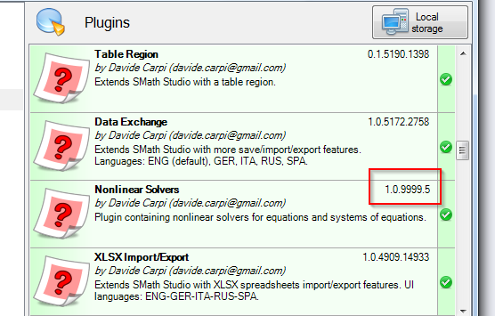

NS version is 1.0.9999.5 for both of you (Martin and Radovan)?
#8 Опубликовано: 03.05.2014 10:24:19
I confirm version 1.0.9999.5 according to plugin dir name. I also tried to change arg/dec sep settings to komma/period and get the same (correct) result.
Hello Davide,
I also confirm the plugin version - see the picture please.
BTW, this is the same on my both computers home-Win7 32bit, office-Win7 64bit

Thanks... I'll check it ASAP, just want to share the latest couple of controls and then I'll go back on this plugin
Added in BTS: SS-139
