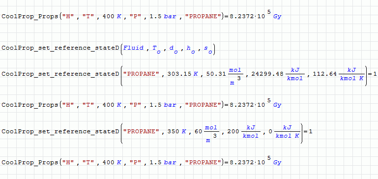

Hi. I don't know how to call the functions CoolProp_set_reference_stateD nor
CoolProp_set_reference_stateS. See the yellow in the attached.

#8 Posted: 6/2/2016 10:41:17 AM
Mike Kaganski
Mike Kaganski
184 likes in 434 posts.
https://github.com/CoolProp/CoolProp/issues/1091
Regarding CoolProp_set_reference_stateS, AFAICT, it works OK, following the definition given in https://github.com/CoolProp/CoolProp/blob/master/include/CoolProp.h :

#9 Posted: 6/2/2016 1:55:47 PM
Regarding CoolProp_set_reference_stateS, AFAICT, it works OK, following the definition given in https://github.com/CoolProp/CoolProp/blob/master/include/CoolProp.h:
In the attached there are a similar information, from github too, but referent to the wrapper. Can provide a smath example changing the refstate and showing h or s values changing? I can't do that inside smath.
Thanks in advance

#11 Posted: 6/2/2016 6:03:44 PM
Mike Kaganski
Mike Kaganski
refstate.sm (48.21 KiB) downloaded 2080 time(s).
WRT CoolProp_set_reference_stateD, I do agree it doesn't work for now, which is why I filed a bug upstream.
С уважением, Михаил Каганский

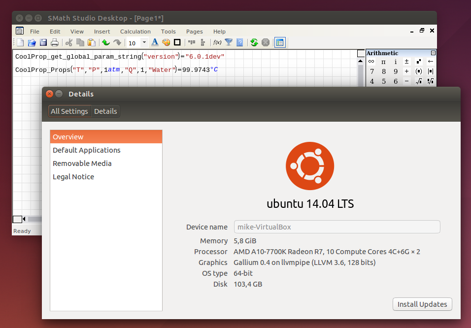

#16 Posted: 6/8/2016 10:05:09 AM
Mike Kaganski
Mike Kaganski
Making it run on mono under Ubuntu:
Hope it will be available in next version of plugin.

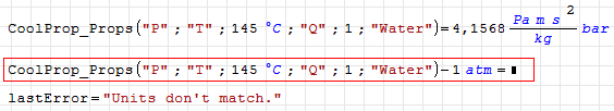

#17 Posted: 10/25/2016 2:17:52 PM
UPDATED Stable: SMath Studio 0.98.6128
- CoolProp 6.1.0;
- refactored to new SS fast interface (please test it a little so I can see if make it stable or I have to fix/change something);
Mike Kaganski 10/25/2016 4:54:00 PM
#18 Posted: 10/25/2016 5:05:43 PM
Mike Kaganski
Mike Kaganski
Thanks, Davide!
Here's what I see:
Also, no dynamic assistance is available. Though disabling the plugin doesn't help.
#19 Posted: 10/25/2016 10:21:34 PM
Though I don't use Smath unit system, two questions come to evidence:
1. 'Q' does not not belong to WASP [WaterSteamProperties].
2. '1' is what ? ... maybe '1' is atm in the 2nd line ?
If "Units don't match": how could the dynamic assistance help ?
The coulomb (unit symbol: C) is the International System of Units (SI) unit of electric charge.
It is the charge (symbol: Q or q) transported by a constant current of one ampere in one second:
1 C = 1 A * 1 s
1 ((Pa * m * s^2) / kg) * bar = 100 000 pascals
#20 Posted: 10/26/2016 4:27:20 AM
Hello Mike,
Reproduced, thank you. I'll fix it ASAP
This is really strange, I have the dynamic assistant both in install and portable versions and using different localizations (languages/symbols) o_o
Hello Jean, according with CoolProp documentation "Q" stands for "Mass vapor quality", thus 1 is 1 mol/mol
I guess it is a separate bug
