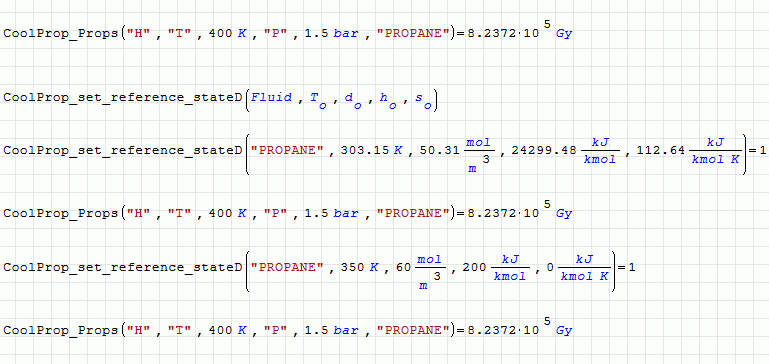

#7 Опубликовано: 02.06.2016 07:00:23
Hi. I don't know how to call the functions CoolProp_set_reference_stateD nor
CoolProp_set_reference_stateS. See the yellow in the attached.
P3.sm (118,57 КиБ) скачан 2031 раз(а).
#8 Опубликовано: 02.06.2016 10:41:17
Mike Kaganski
Mike Kaganski
https://github.com/CoolProp/CoolProp/issues/1091
Regarding CoolProp_set_reference_stateS, AFAICT, it works OK, following the definition given in https://github.com/CoolProp/CoolProp/blob/master/include/CoolProp.h :
    Set the reference state based on a string representation
    @param FluidName The name of the fluid (Backend can be provided like "REFPROP::Water", or if no backend is provided, "HEOS" is the assumed backend)
    @param reference_state The reference state to use, one of
    Reference State | Description
    "IIR"           | h = 200 kJ/kg, s=1 kJ/kg/K at 0C saturated liquid
    "ASHRAE"        | h = 0, s = 0 @ -40C saturated liquid
    "NBP"           | h = 0, s = 0 @ 1.0 bar saturated liquid
    "DEF"           | Reset to the default reference state for the fluid
    "RESET"         | Remove the offset
    The offset in the ideal gas Helmholtz energy can be obtained from
    {Δs}/{R_u/M}+{Δh}/{(R_u/M)T}τ
    where Δs = s-s_{spec} and Δh = h-h_{spec}
    void set_reference_stateS(const std::string &FluidName, const std::string &reference_state);
with the only exception that "RESET" doesn't remove any offset.
С уважением, Михаил Каганский
#9 Опубликовано: 02.06.2016 13:55:47
Regarding CoolProp_set_reference_stateS, AFAICT, it works OK, following the definition given in https://github.com/CoolProp/CoolProp/blob/master/include/CoolProp.h:
In the attached there are a similar information, from github too, but referent to the wrapper. Can provide a smath example changing the refstate and showing h or s values changing? I can't do that inside smath.
Thanks in advance
#10 Опубликовано: 02.06.2016 16:11:35
#11 Опубликовано: 02.06.2016 18:03:44
Mike Kaganski
Mike Kaganski
refstate.sm (48,21 КиБ) скачан 2078 раз(а).
WRT CoolProp_set_reference_stateD, I do agree it doesn't work for now, which is why I filed a bug upstream.

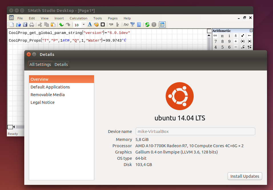

#16 Опубликовано: 08.06.2016 10:05:09
Mike Kaganski
Mike Kaganski
Making it run on mono under Ubuntu:
Hope it will be available in next version of plugin.

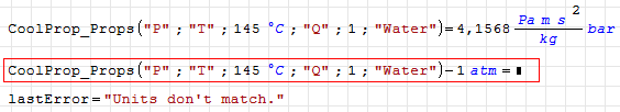

#17 Опубликовано: 25.10.2016 14:17:52
UPDATED Stable: SMath Studio 0.98.6128
- CoolProp 6.1.0;
- refactored to new SS fast interface (please test it a little so I can see if make it stable or I have to fix/change something);
Mike Kaganski 25.10.2016 16:54:00
#18 Опубликовано: 25.10.2016 17:05:43
Mike Kaganski
Mike Kaganski
Thanks, Davide!
Here's what I see:
Also, no dynamic assistance is available. Though disabling the plugin doesn't help.
#19 Опубликовано: 25.10.2016 22:21:34
Though I don't use Smath unit system, two questions come to evidence:
1. 'Q' does not not belong to WASP [WaterSteamProperties].
2. '1' is what ? ... maybe '1' is atm in the 2nd line ?
If "Units don't match": how could the dynamic assistance help ?
The coulomb (unit symbol: C) is the International System of Units (SI) unit of electric charge.
It is the charge (symbol: Q or q) transported by a constant current of one ampere in one second:
1 C = 1 A * 1 s
1 ((Pa * m * s^2) / kg) * bar = 100 000 pascals
#20 Опубликовано: 26.10.2016 04:27:20
Hello Mike,
Reproduced, thank you. I'll fix it ASAP
This is really strange, I have the dynamic assistant both in install and portable versions and using different localizations (languages/symbols) o_o
Hello Jean, according with CoolProp documentation "Q" stands for "Mass vapor quality", thus 1 is 1 mol/mol
I guess it is a separate bug
