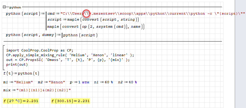

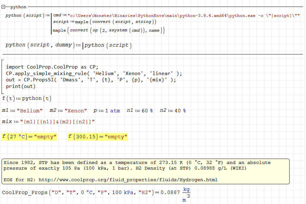

Uni, can you please help me how to add python into SMATH, I have python already in system [WinPython 3.9] How I link it up with Smath?
I have working CoolProp
#70 Опубликовано: 30.07.2023 13:33:42
usamakhan
usamakhan
3 сообщений из 79 понравились пользователям.
Jean, can you help me how do integrate python in my Smath? I event tried environmental variables under Win10 but didn't work

You should use a double slash for the full path.
In this case, you need to check whether python is available from the command line. If not, it means that the paths are specified incorrectly.

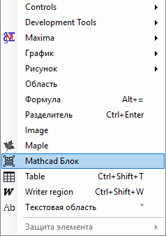

Can you tell me what is this block you used after python sub-section [i.e with the square bracket & holding script conetnts]
Mathcad Block from the Mathcad Toolbox plugin and just Text inside it for the script.
uni, so it means the text inside the block is not automatically generated. Can you please explain the construct

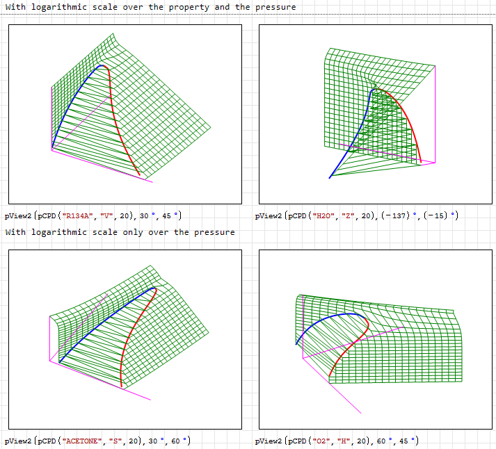

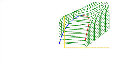

Phase diagrams with CoolProps.
Click to enlarge
PhaseDiagram.sm (39,17 КиБ) скачан 1649 раз(а).
Davide Carpi 08.08.2023 02:10:00

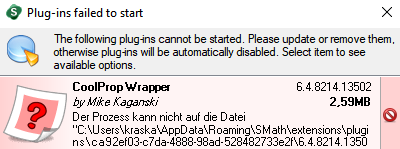

It seems that multiple instances of SMath can't use the plugin at the same time.
How to reproduce:
1. Open SMath and access any Coolprop function
2. Open another SMath instance: You get an error message
#79 Опубликовано: 19.12.2025 01:10:36

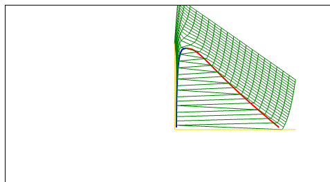

Phase diagrams with CoolProps. ...
Now can show other thermo properties, and get animations.
PhaseDiagram.sm (46,88 КиБ) скачан 641 раз(а).
Animating volume of water and enthalpy of O2.
Вячеслав Мезенцев 19.12.2025 18:44:49, Valery Ochkov 23.06.2026 08:27:38
