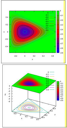

I tried to use the plugin Maxima
PlateMaxima.sm (143.87 KiB) downloaded 1440 time(s).
