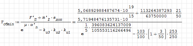

#8 Posted: 3/30/2024 1:40:58 AM
TopUser2000
TopUser2000
0 likes in 28 posts.
Note: it has a little bit of a learning curve, but is worth considering never-the-less.
I don't see the result in the attached screenshots of how it works. A jumble of formulas where there is no clear answer.
