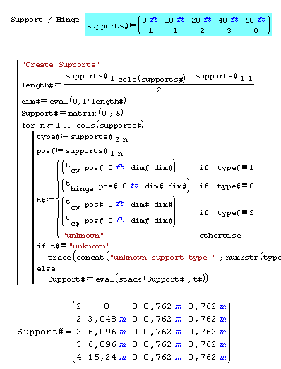

Can you take a look at the attached (scroll down to you see big red text with "problem with cases". I seem to be having a problem with cases(). Maybe there is a better way in general to handle this situation.
Thanks again for your help Martin.

#7 Posted: 2/8/2015 4:19:44 PM
Switch the optimization to numeric (use an eval when you are inside a loop), otherwise you can't mix numbers and strings...
moreover matrix(#,0) is not supported (0 columns) and is converted by SMath into a mat(#,0) - that is a broken mat() function
About units, I think you may define "design base units (lenght/mass/force)" on the top of your worksheet, like in a common FEM program...
FEA Beam - Decon - Preprocessor.sm (127.77 KiB) downloaded 1234 time(s).
#8 Posted: 2/8/2015 10:02:28 PM
Davide, Thanks for the reply.
First let me establish the problem.
I have and input matrix w.p# in which you can define a partial uniform load, a triangular load or a trapezoidal load. However, I need to break down any trapezoidal loads into a uniform load and a triangular load. Therefore I need create a new matrix (change the origonal) which will have 2 columns for every trapezoidal load.
I see your adjustments and at first I had done this. However this creates a "0" column vector for each load, whether it was uniform, triangular or trapezoidal. I was trying to avoid these extra '0' loads by stacking and defining the matrix as "nothing". Similar to how Martin initializes a matrix E=matrix(0,5) and then stacks it will other matrices. I attached another worksheet for reference but it appears the problem is the 'nothing' matrix.

#9 Posted: 2/9/2015 11:55:00 AM
You're welcome
Excuse me, but as an engineer your approach seems to me unnecessarily complicated
Why you don't use something like in the attachment? [you may also extend it with a 2nd if statement to check if the load is triangular]
Beam FEA - partial load cases.sm (35.77 KiB) downloaded 1172 time(s).

#11 Posted: 2/15/2015 12:42:29 PM
Davide, Hopefully my question did not offend you..., sorry if I did.
I receive another odd error using cases.
First error - see attached, BEAM FEA - partial load cases_2
Second Error see attached, BEAM FEA - partial load cases_3
I suspect they are related but not sure how.
Side question -> is there a way for my image to show when using dropbox? Rather than having to click on the 'broken link' image?
Beam FEA - partial load cases_3.sm (29.21 KiB) downloaded 1173 time(s).

#12 Posted: 2/15/2015 7:32:24 PM
I'm not offended, I've just postponed the answer and... forgot about it :d

What is the best way to implement this. For some reason I can't seem grasp the best way to insert or remove rows from matrices (which is a big problem for most programs!)...
If I understand correctly the FEM beam function... to create a "Fixed" support I need to have a t.cw and a t.cphi at the same position. Therefore I need to create a new matrix with an extra support "type" at the same position. What is the best way to do this? See attached for portion of the routine that I am referring to.
Thanks!

#15 Posted: 3/22/2015 5:30:01 AM

Thank you Martin!

Well here it is. Not sure how stable it is as I have only limited testing. I wish the graph was easier to move around.
My next effort with be to allow multiple E, I inputs, but for now I will use this mostly for simple span beams.
I also want to create a "steel beam size optimization routine". The problem though is importing the steel beam sizes and properties. The matrix is just so large that it really slows the calculation down.
BeamFEA_1 Input-Result.sm (39.74 KiB) downloaded 1182 time(s).
