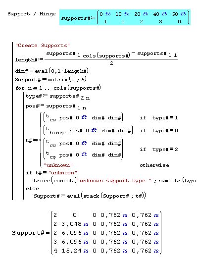

Quick question:
Is there a good way to "recognize and strip" units? Currently we define what units we are working in. I would like to directly input the values into the function I would need to recognize which units are being used, then strip them, then re-apply them at the end.
Thanks again.
Thanks again.

Switch the optimization to numeric (use an eval when you are inside a loop), otherwise you can't mix numbers and strings...
moreover matrix(#,0) is not supported (0 columns) and is converted by SMath into a mat(#,0) - that is a broken mat() function
About units, I think you may define "design base units (lenght/mass/force)" on the top of your worksheet, like in a common FEM program...
FEA Beam - Decon - Preprocessor.sm (127,77 КиБ) скачан 1234 раз(а).

I'm not offended, I've just postponed the answer and... forgot about it :d
Excluding (commercial) FEA packages, there are useful free tools here and there, some excel spreadsheet, and there is also some good free FEA program (like OpenSees).
IMHO the main issue of self-made programs is that if you don't have feedbacks from a community, you spend a lot of time and energy for something that might contain a lot of hidden bugs and probably will be set aside in favor of something else when you will have to modify or expand it to some particular case (because the complexity, the time available, ...)
About the latest issues, the key is again the optimization. You have to set it to numeric (using eval() where you can't do it for some reason)
cases() is nothing else that an interface to a nested if/else structure. Because if/else is not supported by SMath's integrals, I've extended cases with a mathematical/boolean version of that nested structure; this is triggered when you choose the symbolic optimization. Thus If cases() with symbolic optimization contains elements that cannot be summable (matrices with different sizes, strings, etc), the summation fails and an error is returned.
About dropbox, the reason because we can't see the images is probably because the link is the link to a page that contains an image, and not to the image itself; to have a link to the image, replace ?dl=0 with ?raw=1

What is the best way to implement this. For some reason I can't seem grasp the best way to insert or remove rows from matrices (which is a big problem for most programs!)...
If I understand correctly the FEM beam function... to create a "Fixed" support I need to have a t.cw and a t.cphi at the same position. Therefore I need to create a new matrix with an extra support "type" at the same position. What is the best way to do this? See attached for portion of the routine that I am referring to.
Thanks!
Thanks!

Thank you Martin!
Well here it is. Not sure how stable it is as I have only limited testing. I wish the graph was easier to move around.
My next effort with be to allow multiple E, I inputs, but for now I will use this mostly for simple span beams.
