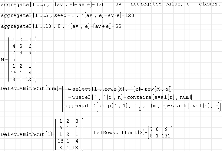

Mike Kaganski 4/25/2014 8:16:00 AM

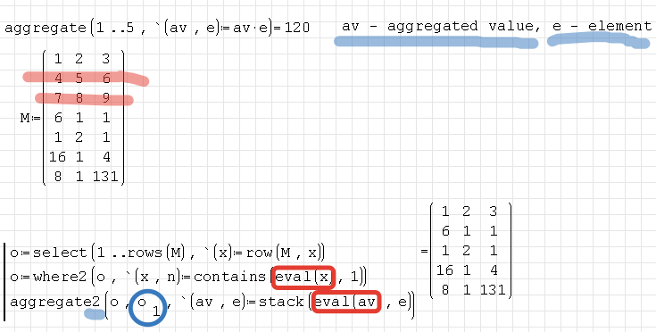

Updated. aggregate() - fixed.
Davide Carpi 4/25/2014 9:42:00 AM

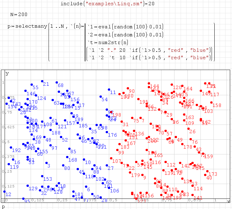

Davide Carpi 4/25/2014 6:24:00 PM, Radovan Omorjan 4/26/2014 2:42:00 AM

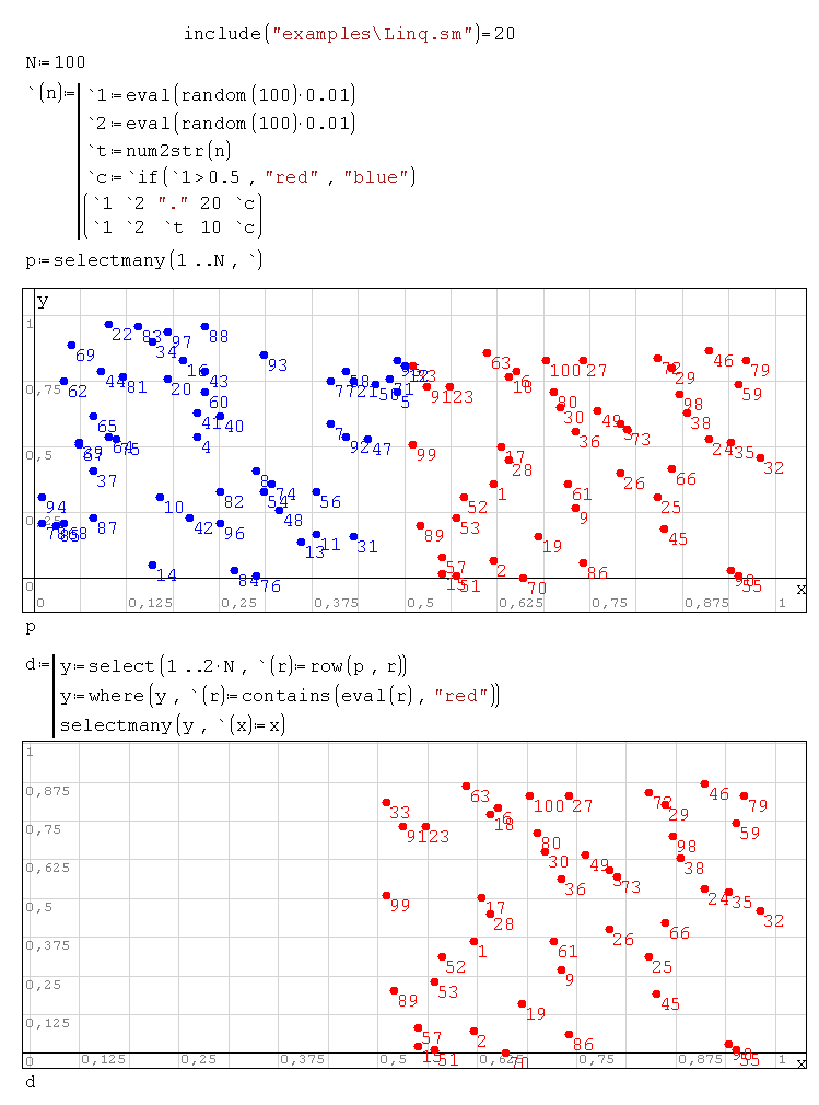

Plot example.
Linq. Plot.sm (7.04 KiB) downloaded 1227 time(s).
Radovan Omorjan 4/26/2014 2:42:00 AM, Davide Carpi 4/25/2014 9:10:00 PM

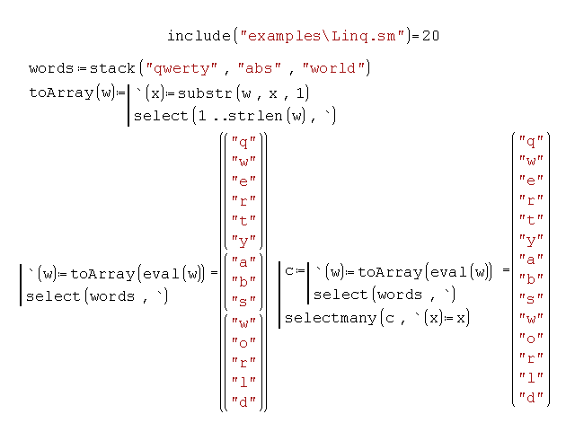

selectmany example.
Linq. selectmany.sm (7 KiB) downloaded 1198 time(s).

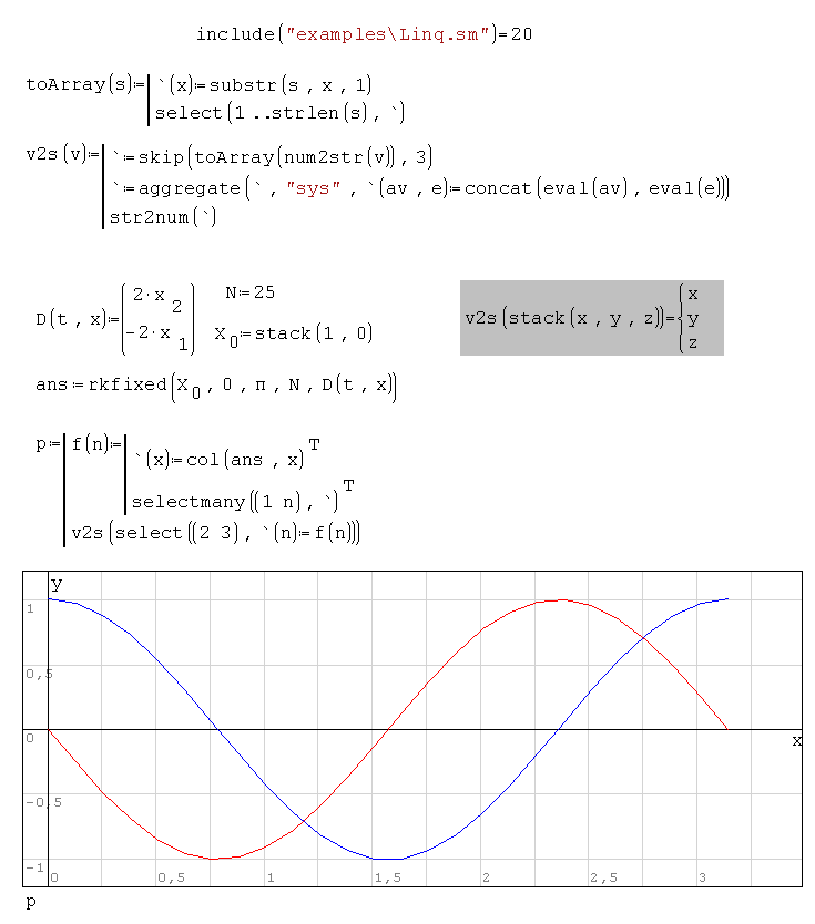

ODE plot.
Linq. ODE plot.sm (10.3 KiB) downloaded 1232 time(s).
Radovan Omorjan 4/26/2014 2:43:00 AM, Davide Carpi 4/25/2014 9:10:00 PM
