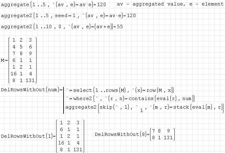

Updated. Small improvements.
P.S. Here, the aggregate function is implemented not correctly.

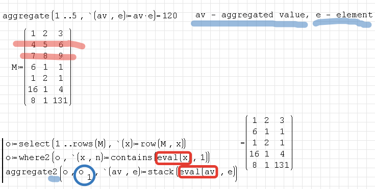

#8 Опубликовано: 25.04.2014 08:58:34
Updated. aggregate() - fixed.

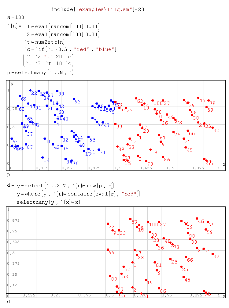

#12 Опубликовано: 25.04.2014 17:49:29
Updated.
Unfortunatelly, nested queries not supported.

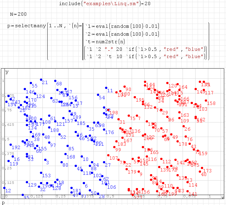

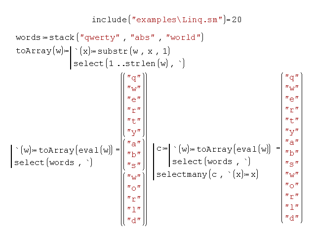

#14 Опубликовано: 25.04.2014 19:22:45
selectmany example.

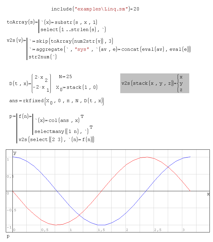

#15 Опубликовано: 25.04.2014 20:43:19
ODE plot.
