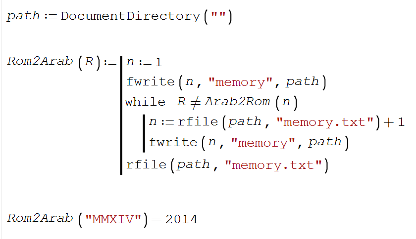

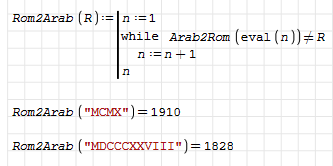

Why doesn't the cycle end?
See please the attachRome-Arab.sm (40.3 KiB) downloaded 1324 time(s).
#2 Posted: 10/19/2023 12:53:00 AM
Oscar Campo
Oscar Campo
135 likes in 309 posts.

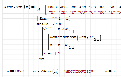

Really it's a very strange bahavior (a bug ?), because the value of variable n is cleared when function returns from Arab2Rom()
So, a solution is to use functions fwrite() and rfile() to save the value of n on a file as a memory:
See the atachment with the solution: Rome-Arab SOLVED.sm (41.21 KiB) downloaded 1311 time(s).
best,
Oscar

Hi. In Arab2Rom(n) you modify n.
That's not good practice. This is a workaround for such cases.

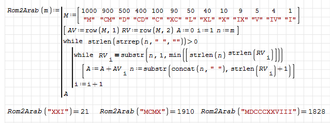

But this have an error too!
Rom2Arab.sm (293.29 KiB) downloaded 1320 time(s).
#5 Posted: 10/19/2023 1:52:56 AM
1,123 likes in 1,795 posts.
Thanks!
That's another function, not similar with the others above. Here the problem is the origin in Mathcad for strings. Try to set ORIGIN = 1 in Mathcad and rewrite the code.

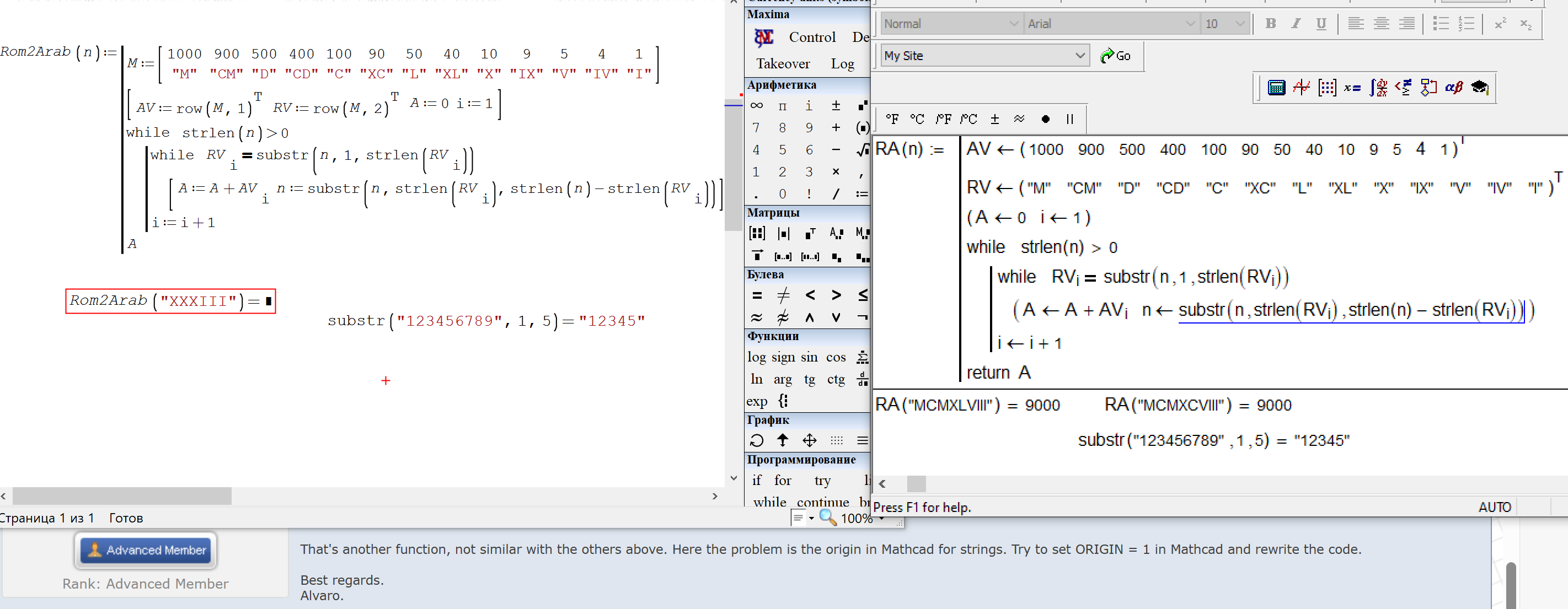

#7 Posted: 10/19/2023 2:43:57 AM
This is one way.
Valery Ochkov 10/19/2023 2:49:00 AM

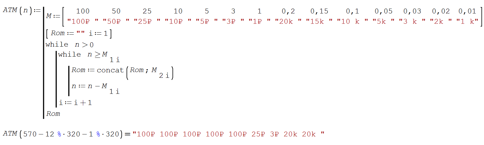

My salary in 1980
ATM-SU.sm (6.29 KiB) downloaded 1298 time(s).
