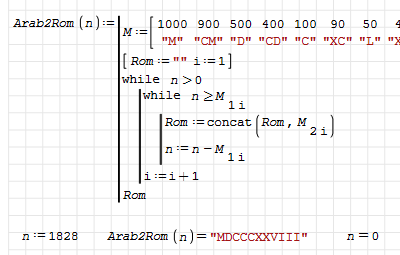

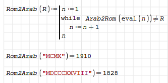

Why doesn't the cycle end?
See please the attachRome-Arab.sm (40,3 КиБ) скачан 1451 раз(а).

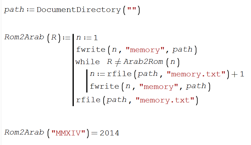

Really it's a very strange bahavior (a bug ?), because the value of variable n is cleared when function returns from Arab2Rom()
So, a solution is to use functions fwrite() and rfile() to save the value of n on a file as a memory:
See the atachment with the solution: Rome-Arab SOLVED.sm (41,21 КиБ) скачан 1436 раз(а).
best,
Oscar
Valery Ochkov 19.10.2023 01:08:00

Hi. In Arab2Rom(n) you modify n.
That's not good practice. This is a workaround for such cases.
Valery Ochkov 19.10.2023 01:46:00, Oscar Campo 19.10.2023 01:46:00

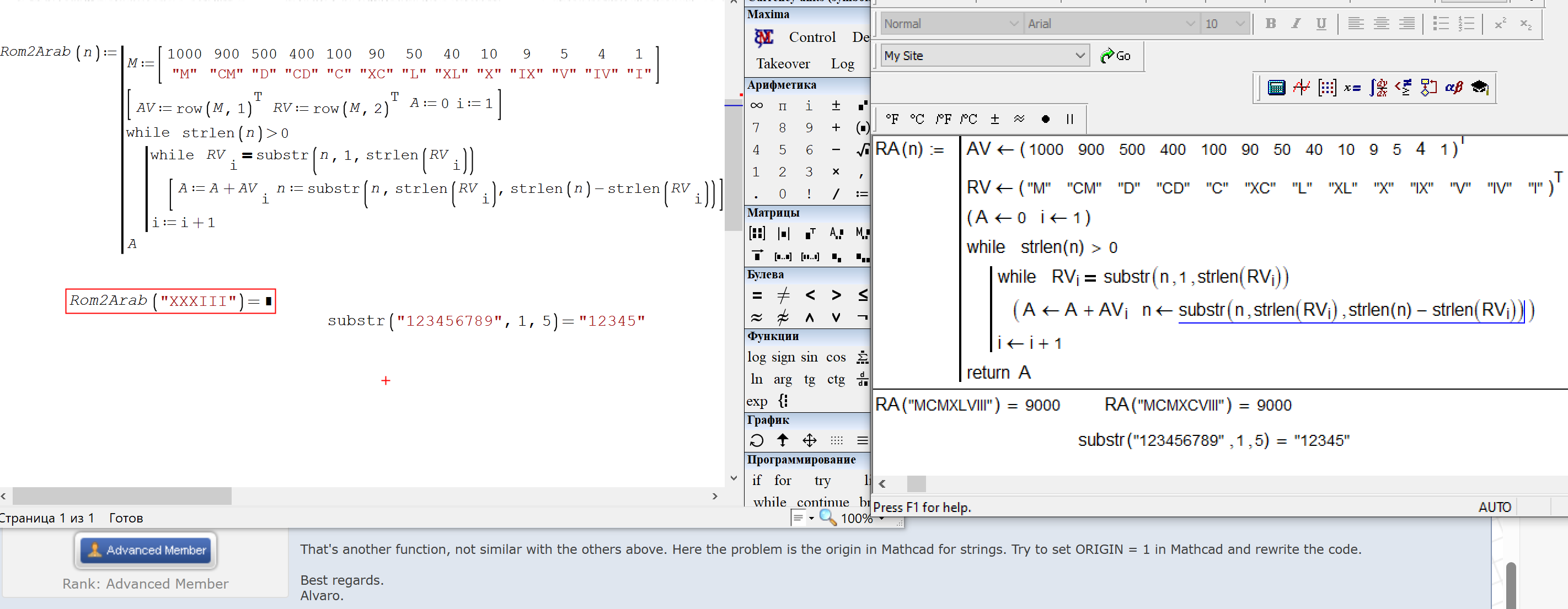

But this have an error too!
Rom2Arab.sm (293,29 КиБ) скачан 1429 раз(а).
#5 Опубликовано: 19.10.2023 01:52:56
Thanks!

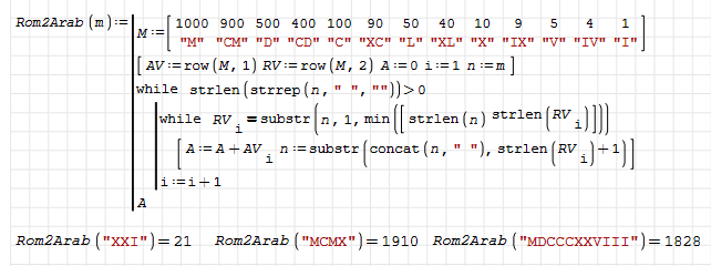

That's another function, not similar with the others above. Here the problem is the origin in Mathcad for strings. Try to set ORIGIN = 1 in Mathcad and rewrite the code.

This is one way.
Valery Ochkov 19.10.2023 02:49:00

This is one way.
Thanks,
send please the sm-file!

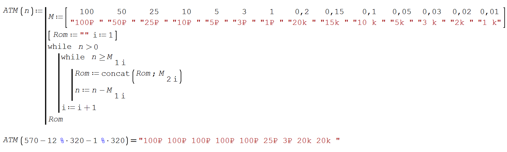

My salary in 1980
ATM-SU.sm (6,29 КиБ) скачан 1438 раз(а).
