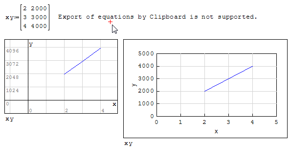

Not sure if you mean that it works for you, or have you done something to get it to scale the axes. Here is what it looks like for me (cloud or studio)
Data is not shown on axes - axes do not autoscale
#11 Posted: 4/3/2018 12:16:40 AM
X_Y plot => you set the x, y limits
the QuickPlot => you wheel/mouse/zoom the x, y
Shift wheel mouse for the x
Ctrl wheel mouse for the y
click in plot shift up/dn, left/right to move the plot.

The @ plot is the quick plot. You are correct, it does not autoscale. The X-Y plot that Jean mentioned is a plugin for the PC based software.
I agree, an auto zoom to the correct plot area would be nice
