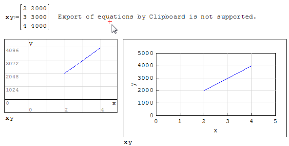

Not sure if you mean that it works for you, or have you done something to get it to scale the axes. Here is what it looks like for me (cloud or studio)
Data is not shown on axes - axes do not autoscale
#11 Опубликовано: 03.04.2018 00:16:40
X_Y plot => you set the x, y limits
the QuickPlot => you wheel/mouse/zoom the x, y
Shift wheel mouse for the x
Ctrl wheel mouse for the y
click in plot shift up/dn, left/right to move the plot.

The @ plot is the quick plot. You are correct, it does not autoscale. The X-Y plot that Jean mentioned is a plugin for the PC based software.
I agree, an auto zoom to the correct plot area would be nice
Smath default QuickPlot [Shift+@] is same as Mathcad [± 10]
For Smath auto-zoom it would need the XY plot arguments
independent, same style as Mathcad. Even then, you have
to set each direction wrt to the data.

Today I am looking for a tool that provides an easy way for noobs
to do a very simple task: enter a small set of data, and plot it.
How can it be simpler than actually ?
Plug your argument [here matrix], click in the plot, rotate wheel mouse <=,=>
Your specific request: Plenty of gadgets for noobs, why an Smath for noobs ?
Not as easy as it looks, like this ... try from free web gadgets.
