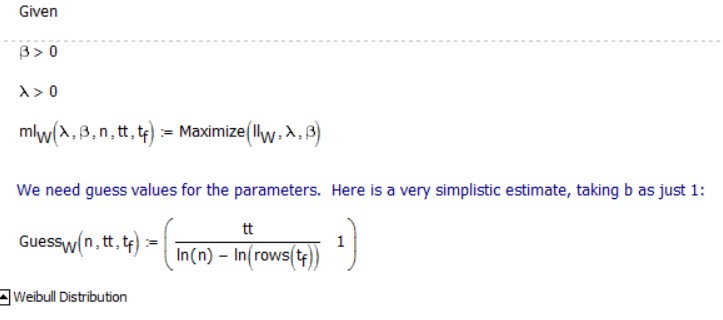

I have tried to convert the attached MC15 worksheet to SMATH. I cannot work around the solve block (Maximize) successfully. I welcome the collabs review and recommendation(s).
The solve block is in the "Weibull Distribution" area (collapsed).
nas

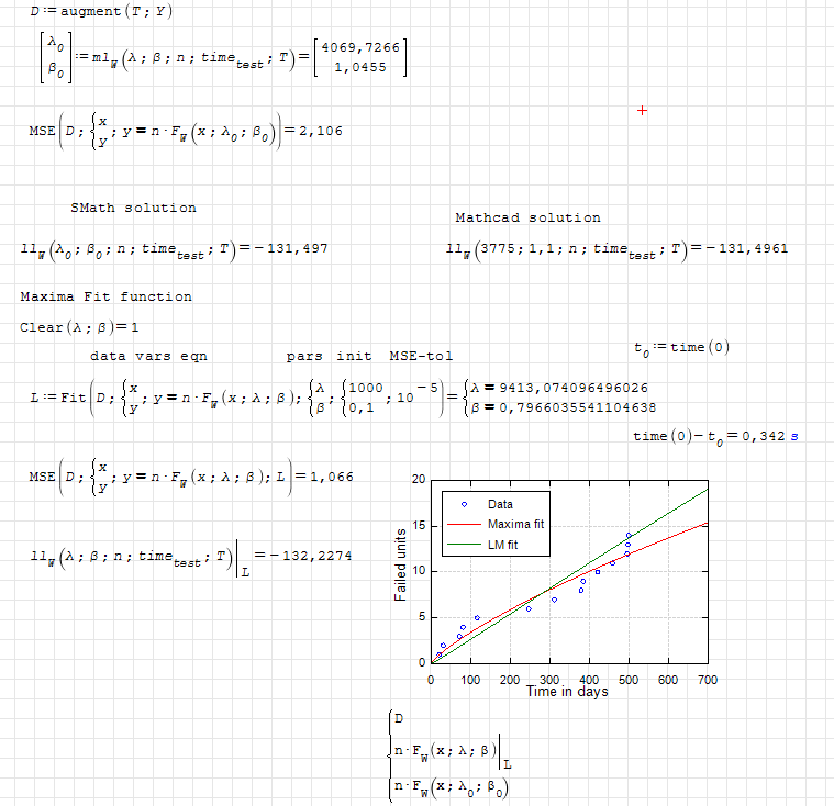

Fit using Maxima's lsquares package. MSE() is the mean square error, which is minimized by Fit()
2018-09-10 11_11_54-SMath Studio 0.99.6671 - [Chain%20Failure%20Weibull%20Analysis%20-%203.sm_].png
Chain%20Failure%20Weibull%20Analysis%20-%203_Kr.sm (78.46 KiB) downloaded 1289 time(s).
frapuano 9/10/2018 9:23:00 AM

Alvaro, jmg and Martin, many thanks!
Martin's requires a newer version of SMATH installed, I'll have to request the upgrade to be installed.
