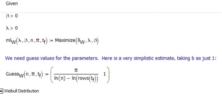

I have tried to convert the attached MC15 worksheet to SMATH. I cannot work around the solve block (Maximize) successfully. I welcome the collabs review and recommendation(s).
The solve block is in the "Weibull Distribution" area (collapsed).

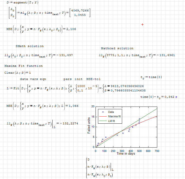

Fit using Maxima's lsquares package. MSE() is the mean square error, which is minimized by Fit()
2018-09-10 11_11_54-SMath Studio 0.99.6671 - [Chain%20Failure%20Weibull%20Analysis%20-%203.sm_].png
Chain%20Failure%20Weibull%20Analysis%20-%203_Kr.sm (78,46 КиБ) скачан 1289 раз(а).
frapuano 10.09.2018 09:23:00

Alvaro, jmg and Martin, many thanks!
Martin's requires a newer version of SMATH installed, I'll have to request the upgrade to be installed.

Should work with SMath build 6671 as well (latest stable with updated plug-ins), just ignore the complaints.
