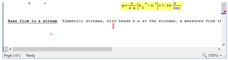

I typed a long SMath Studio file using the latest stable version. After saving the file, and re-opening I get a red bar and missing half of my document. Is there any way to recover it? It has happened to me at least three times since I loaded the last version of SMath Studio. I had produced PDF files from my other files, so I didn't worry much. But this one I spent a long time typing and didn't printed it to PDF before closing it. HELP!

There was an empty region in the file with missing end tag. Deleting the highlighted line solves the problem.
The problem is reproducible if you create an empty text region (typing " ) and then save the file.

As I opened the work sheet, the scroll bar didn't report red dot,
only a red | in the empty text box. True: past | empty.
