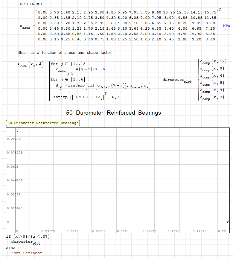

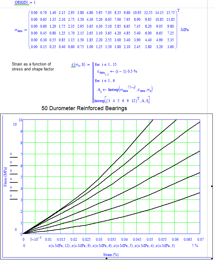

Question: Below is a screenshot of a 2D plot I can pull off in Mathcad. Does Smath studio have the ability to do similar? I was looking in the wiki and other examples, it seems as if they might be an option, but I can't find anything for defining X-Y plot limits. I think I can pull off the multiple lines with the System of Values smath command, and get each of those durometer lines at 12, 9, 6, 5, 4, and 3. But I am struggling with getting it to plot anything at all.
Mathcad:
What I have in Smath so far:
FYI, I use Sigma.comp in several places in the worksheet, and it returns expected values. So that definition and the linear interpolation is functioning properly. Thoughts?
Thanks,
Mike

#2 Posted: 5/13/2020 5:49:34 PM
Try X-Y Plot Region and attach the document.

#4 Posted: 5/14/2020 1:26:05 PM
Thanks...I did not have X-Y Plot region addon. With it - I was able to get an output:
Does all that I need it to do. Only other option - see how MathCAD allows inverting access, or call Y-Axis range into equation. So I reversed position as X-Y Plot only seems to pull input from X-Axis. Is there a way to call Y-Axis?

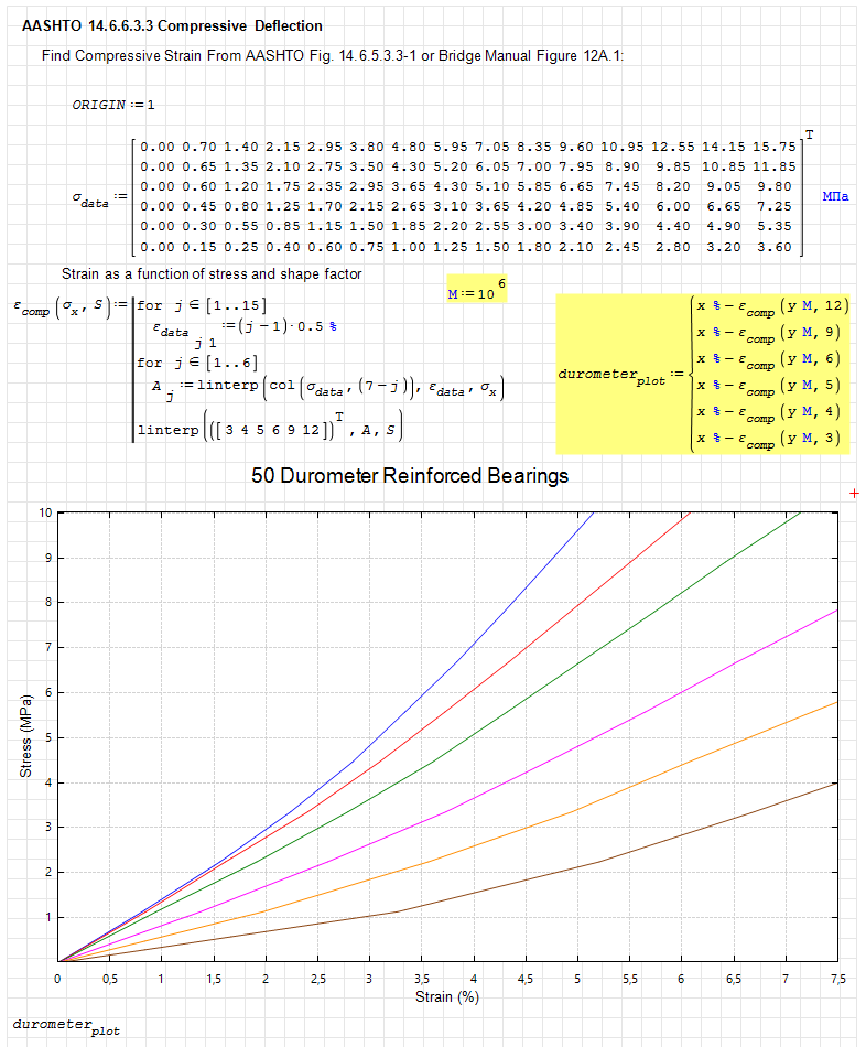

#9 Posted: 5/14/2020 6:31:12 PM
Like this. Implicit plot mode used.
USC EB EXP LFD (uni).sm (130.45 KiB) downloaded 1125 time(s).

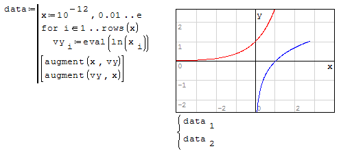

#11 Posted: 5/14/2020 10:17:14 PM
#12 Posted: 5/14/2020 10:43:50 PM
You just have a data set from some standard.
You can interpolate from the 2D spline module,
as well you can plot each interpolated column.
You first have to metric each direction X Y.
USC unknown.sm (30.7 KiB) downloaded 1134 time(s).
#13 Posted: 5/14/2020 11:03:56 PM
Thanks Jean / Viacheslav...from examples provided, how the X-Y Plot Plugin uses the arguments makes more sense. Simple test - My_Function: x-y^2 yields a simple parabola. It just plots whatever equation of a line is provided. High School math, simple but effective! Much more intuitive than how Mathcad does it (in my humble opinion). So used to doing it the Mathcad way, I am not seeing the obvious sometimes in Smath.
