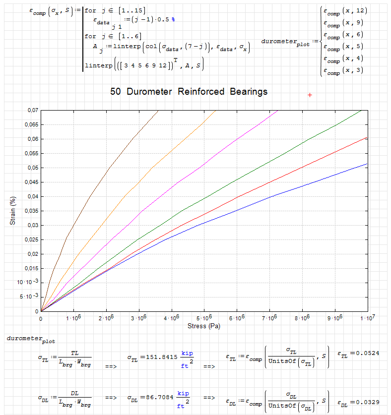

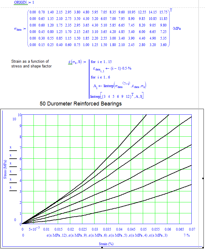

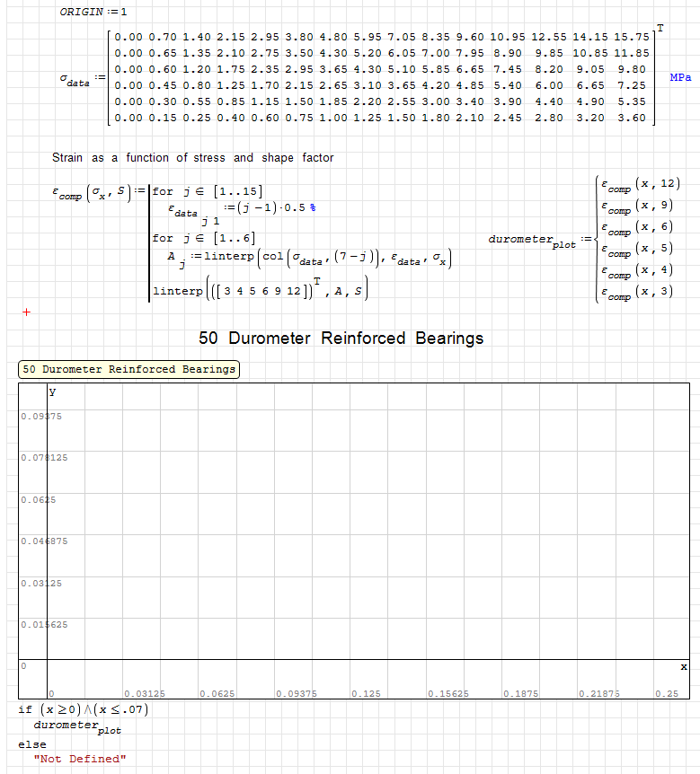

Hello again,
Question: Below is a screenshot of a 2D plot I can pull off in Mathcad. Does Smath studio have the ability to do similar? I was looking in the wiki and other examples, it seems as if they might be an option, but I can't find anything for defining X-Y plot limits. I think I can pull off the multiple lines with the System of Values smath command, and get each of those durometer lines at 12, 9, 6, 5, 4, and 3. But I am struggling with getting it to plot anything at all.
Mathcad:
What I have in Smath so far:
FYI, I use Sigma.comp in several places in the worksheet, and it returns expected values. So that definition and the linear interpolation is functioning properly. Thoughts?

#2 Posted: 5/13/2020 5:49:34 PM
1,555 likes in 1,867 posts.
Try X-Y Plot Region and attach the document.

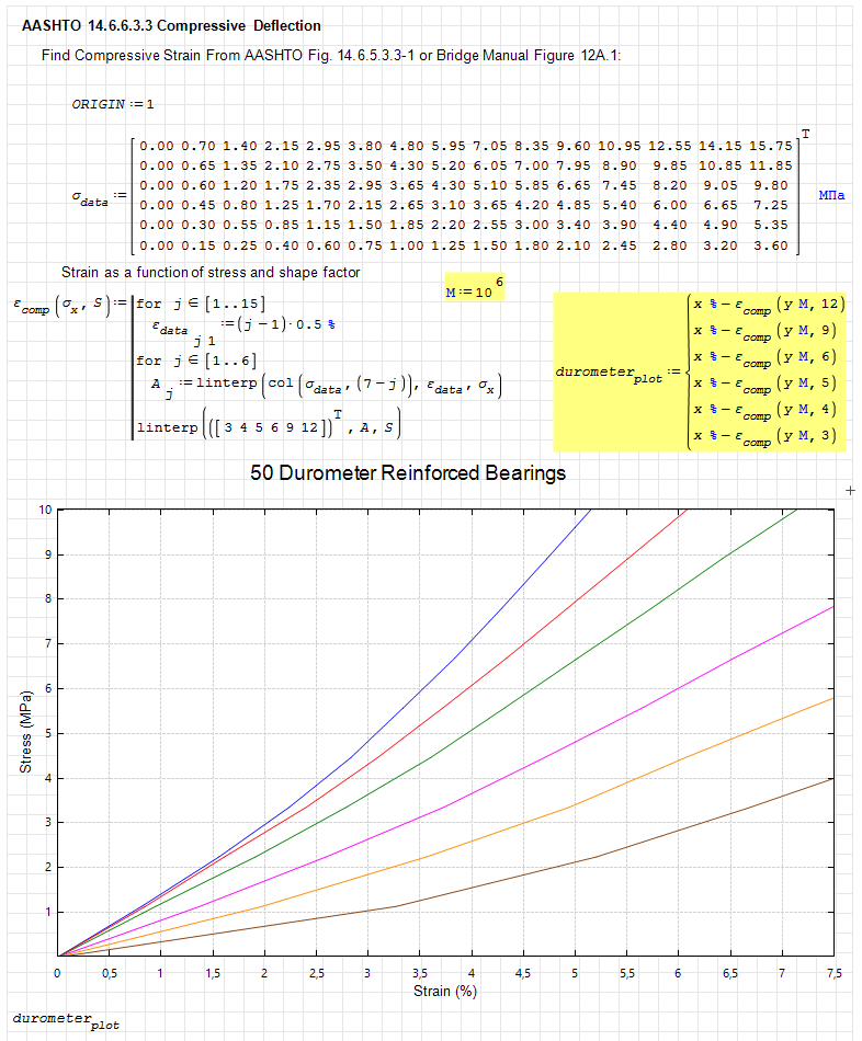

Thanks...I did not have X-Y Plot region addon. With it - I was able to get an output:
Does all that I need it to do. Only other option - see how MathCAD allows inverting access, or call Y-Axis range into equation. So I reversed position as X-Y Plot only seems to pull input from X-Axis. Is there a way to call Y-Axis?

#9 Posted: 5/14/2020 6:31:12 PM
Like this. Implicit plot mode used.
USC EB EXP LFD (uni).sm (130.45 KiB) downloaded 1125 time(s).
USC EB EXP LFD (uni, page 3).pdf (155.63 KiB) downloaded 677 time(s).

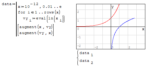

You just have a data set from some standard.
You can interpolate from the 2D spline module,
as well you can plot each interpolated column.
You first have to metric each direction X Y.
USC unknown.sm (30.7 KiB) downloaded 1134 time(s).
