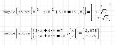

for simple parametric equations, you can use the integrated
solver without problem (solve with lowercase "s" )
and for Maxima Solve (with a capital "S" ) you must use the right button of
the mouse and select optimize symbolically, that is the only detail you are
missing to obtain the answer you are looking for.
If you want to obtain results, the 2 expressions in the image above must be
evaluated with symbolic optimization.
Solve gives you a result, but does not define "x"
that's why you get the error x undefined
you can use Assign so that "x" is now defined

fractions to decimal :
with numeric optime, but remember you firsth must declare x & y
with Assign command.
