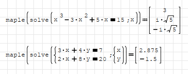

Maple plugin can also solve equations.
And it doesn't require any additional software.
Just simple one click installation from plugins.
Though it will not write x=*** or y=***.
