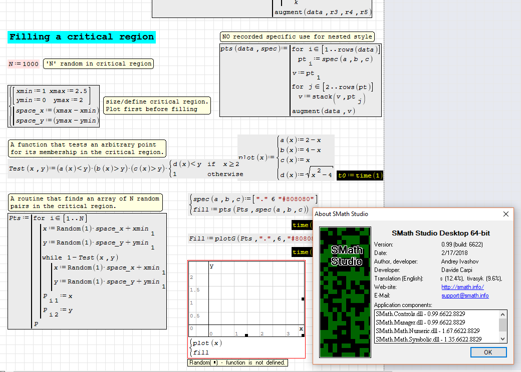

Jean,
It does not work in 6622.
In Graph: (does not display any graph)
Error: Random()= Function is not defined.
Thanks,

SMath-01.PNGHello Andrey,
Attached please find a print screen.
Am I doing something wreong?
Thank you,
Basile

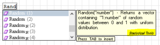

SMath-02.PNGIt looks that it is...
Please could you check what plug-in handles Random function in your case?
Also please try to test Random function... will it work in most usual scenarios on your environment?

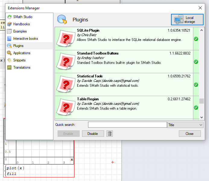

SMath-03.PNGHere it is...
And how do you want me to test the Rand, please?

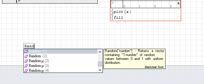

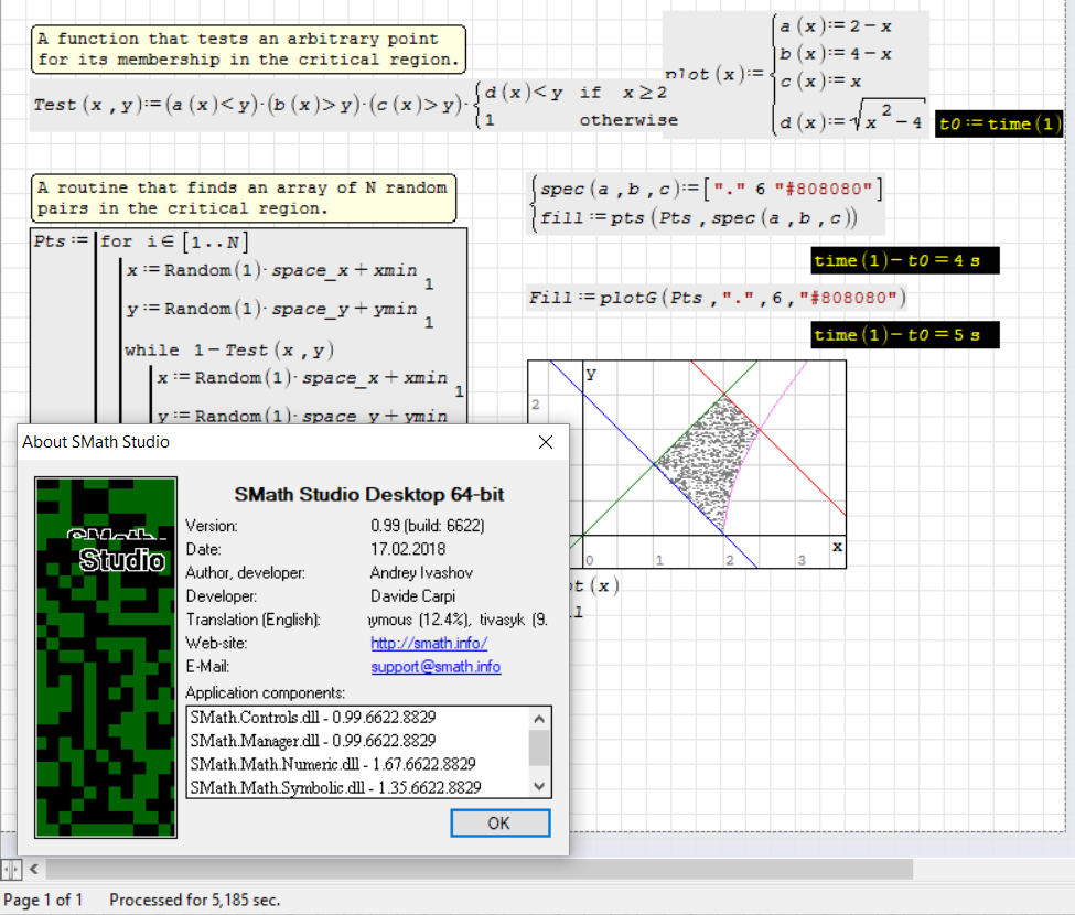

SMath-04.PNGJean,
I run your and I get:
Basile

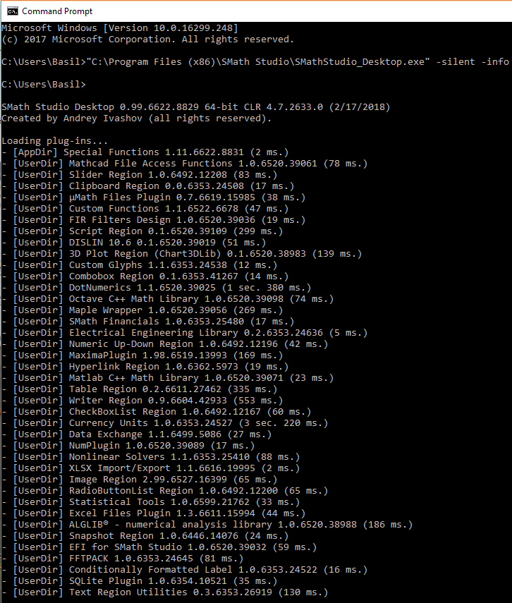

Not sure, but may be this is because of sort order of plug-ins or some additional plug-in which breaks the logic...
Please could you execute the following in command line? (path to SMathStudio_Desktop.exe may differ on your PC)
"C:\Program Files (x86)\SMath Studio\SMathStudio_Desktop.exe" -silent -info
I would like to see the output of this command in order to try to reproduce this on my environment.

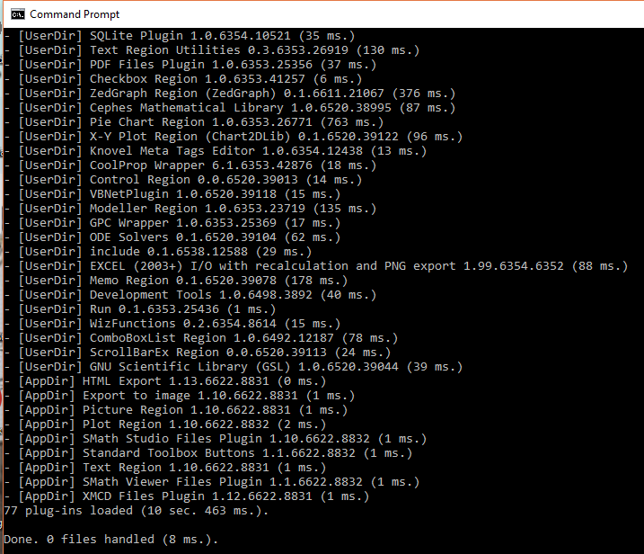

SMath-05.PNGHere it is:

#15 Posted: 2/21/2018 3:59:05 AM
2,343 likes in 4,043 posts.
Thank you very much! Now I have everything to try reproducing this issue.
