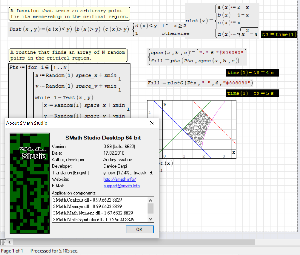

This refactored style is ~ 25 times faster than the very original.
The nested style does not ring a bell about specific use ?
Random_8 Fill Critical Region.sm (17,72 КиБ) скачан 1202 раз(а).

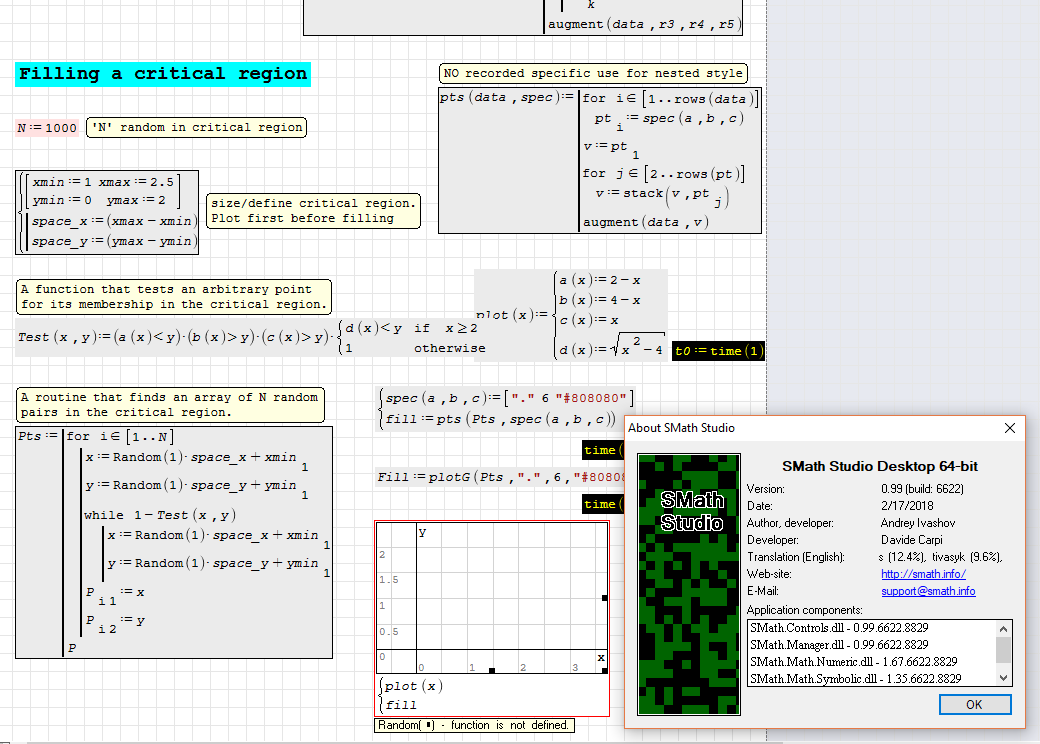

#4 Опубликовано: 18.02.2018 16:49:32
Basile
Basile
SMath-01.PNGHello Andrey,
Attached please find a print screen.
Am I doing something wreong?
Thank you,
Basile

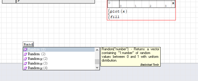

#5 Опубликовано: 18.02.2018 16:50:32
Random(..) function is from Statistical Tools plug-in. Please check if this plug-in available on your PC.
#6 Опубликовано: 18.02.2018 17:05:33
Basile
Basile
SMath-02.PNGIt looks that it is...

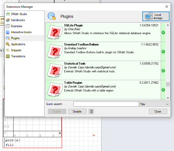

#7 Опубликовано: 18.02.2018 17:21:15

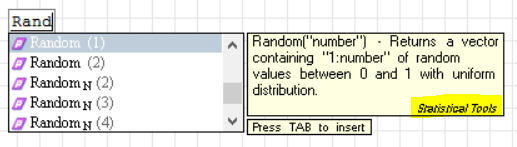

Please could you check what plug-in handles Random function in your case?
Also please try to test Random function... will it work in most usual scenarios on your environment?
#8 Опубликовано: 18.02.2018 18:45:09
Basile
Basile
SMath-03.PNGHere it is...
And how do you want me to test the Rand, please?
#9 Опубликовано: 18.02.2018 22:10:38
Am I doing something wrong?
Maybe YES, maybe NO ... maybe an undetected bug wrt your version,
though Andrey said/proved it works. If you visit "Samples", you
will find a huge "Random Utilities" [not more than a month old].
Cheers Basile, Jean

#10 Опубликовано: 19.02.2018 09:52:38
Basile
Basile
SMath-04.PNGJean,
I run your and I get:
Basile

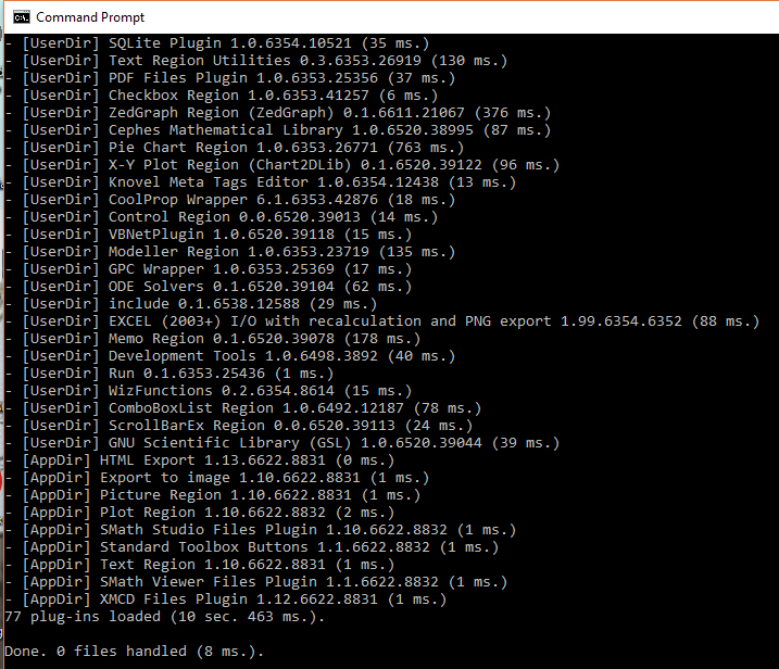

#12 Опубликовано: 19.02.2018 14:46:31
Not sure, but may be this is because of sort order of plug-ins or some additional plug-in which breaks the logic...
Please could you execute the following in command line? (path to SMathStudio_Desktop.exe may differ on your PC)
"C:\Program Files (x86)\SMath Studio\SMathStudio_Desktop.exe" -silent -info
I would like to see the output of this command in order to try to reproduce this on my environment.
Davide Carpi 19.02.2018 20:37:00

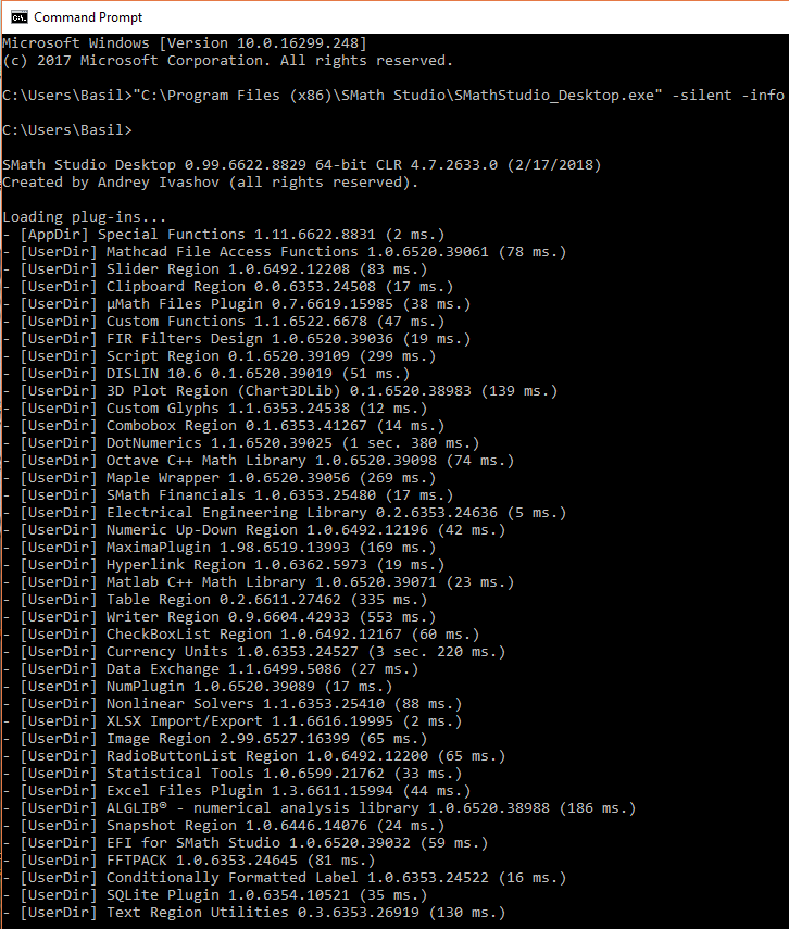

#13 Опубликовано: 19.02.2018 22:09:18
Basile
Basile
SMath-05.PNGHere it is:
