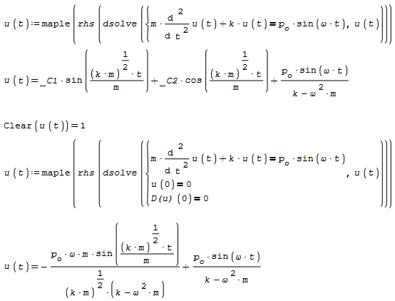

Thank you. How do you input ",u(t)" in the brace?
#6 Posted: 7/1/2024 1:06:09 PM
WroteWrote
Symbolic results from ODE.sm (9.74 KiB) downloaded 1500 time(s).
I think so
dsolve( , u(t))
netsonicyxf 7/1/2024 9:44:00 PM
#7 Posted: 7/2/2024 10:34:21 PM
Plugin less solution, with units, using the Wronskian and the variation of parameters method.
Symbolic results from ODE.sm (23.52 KiB) downloaded 1463 time(s).
