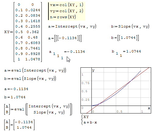

Can't explain to myself double/triple nesting [6179 Win 7].

something to check in the symbolic engine; change the optimization of a:Intercept(vx,vy) from symbolic to numeric

Thanks Davide ... works fine Numeric !

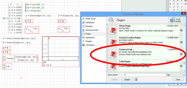

I get these errors when I run the file:
Carlos

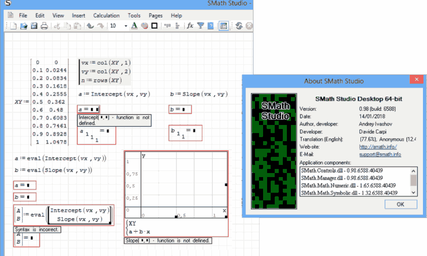

Thanks Jean, but I get the same error.
Is your Smath studio 32-bit?
My Smath Studio 64-bit, does not recognize the
functions of Interception and slope.
Carlos

Hello!
Jean's example also works in my laptop (Win 10, 64 bit) with latest SS 6588 dated 14/01/2018.
The Functions are in Statistical Tools Plugin.

Carlos, do you have statistical tools plug-in installed and enabled?

Yes I have it.
Carlos
